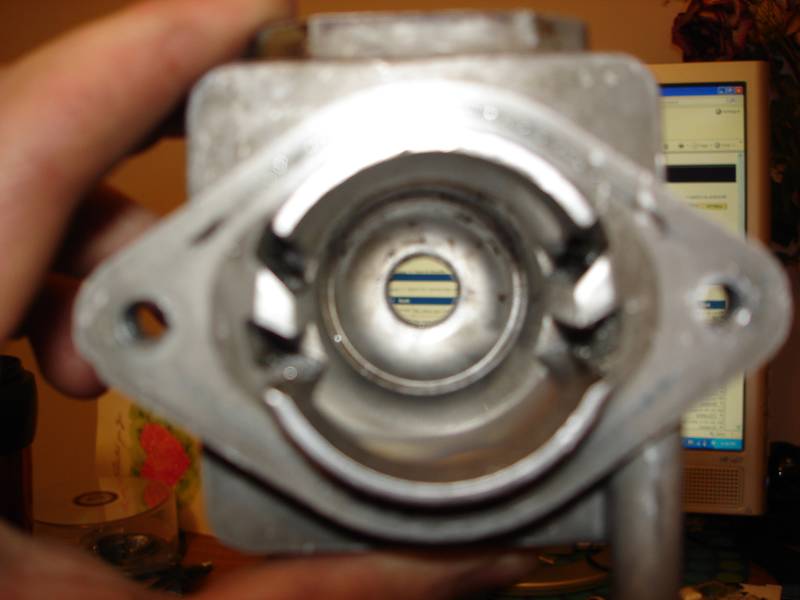

well, after staring at my broken ryobi most of the winter, ive finally worked up the motivation to try and tune this thing for more power. when i had it, it was decent for power in the plane that i had it in, but i want enough for aerobatics.
so far i have removed the head gasket to increase compression and raised the exhaust port to a duration of 150 Degrees.
this is when i got the idea to modify the transfer ports........
i looked at my homelite 25cc jug and noticed that the transfer ports looked like this: [img][/img], and my ryobi transfer ports looked like this: [img][/img],
so i modified them to look like this: [img][/img],
do you guys think that this will work? or did i just ruin a perfectly good jug?
your input is greatly appreciated.
thx,
andrew

sorry 'bout the pics, cameras and me dont get along.
about the rings, the rings for this engine are .047thick so i dont think that they would bulge out. and the transfers arent a whole lot wider than the homelite...but iguess i will find out when i run this thing. right now i just need a case (in the process of taking care of that) piston rings, prop hub and to modify the muffler and im ready to go.
when the weather gets nicer (right now its still too cold to be outside playing with engines) i will run it.
my target RPM is 75oo-7800 with an 18-8 prop.

Andrew,
The cylinder looks like a Ryobi, but I haven't seen one with dual transfer passages before. The reason for the wide bridge in the middle of the transfer area is to provide a support for the trust side of the piston. Now it appears that there is no support and it will wear very fast. Ryobi's have a tendency to wear in this area with a stock cylinder. If the drag isn't to great, it will produce more power. Are the two pictures on the right from a Ryobi?
Dave

the two pics are a ryobi. the first one is what the cylinder looked like before the mod, and the second one is of the mod that i did.
there is still quite a bit of cylinder left to support the ring (more than a homelite) so i am pretty confident that this will work.

Andrew66: The reed valve is a check valve. It lets fuel & air in but not back out. The "mod" you done looks like just cutting the support out to make ports wider. Is that correct? Capt,n

yes, i figured i would try to open up the transfers to allow more flow. the stock configuration doesnt allow much flow, which i think is one of the reasons that the ryobi isnt a power house.
