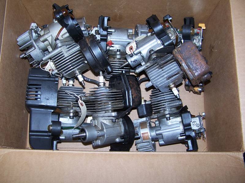

Ernest2, OK, you need a cheap carb. My van will not let me pass a small-engine repair shop, and me and the van always wind up in the parking lot. I go inside, donate a couple of pesos to the coffee-and-donuts fund, and walk out with a load of “dead” chainsaws, weedies, leaf blowers, etc. To me it’s gold. To them it’s junk that they have to pay for hauling to a recycle center. I do it gratis, and even help keep their coffee pot happy. In short order, I ran out of room to store my treasure. I had lots of good carbs and even complete engines. So if you can do this, just look over your collection and see if you have a two-needle carb with the same basic configuration as the OEM carb. OK, you only need one carb...that should be easy. I hope this helps you. One warning: Once you get started, this can get addictive, and you will have more engines than you know what to do with. [X(]
R.C.
