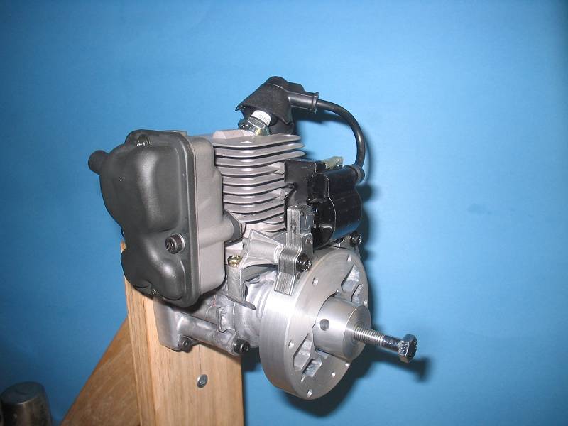

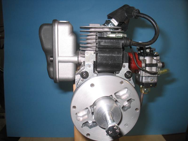

Tanaka conversion

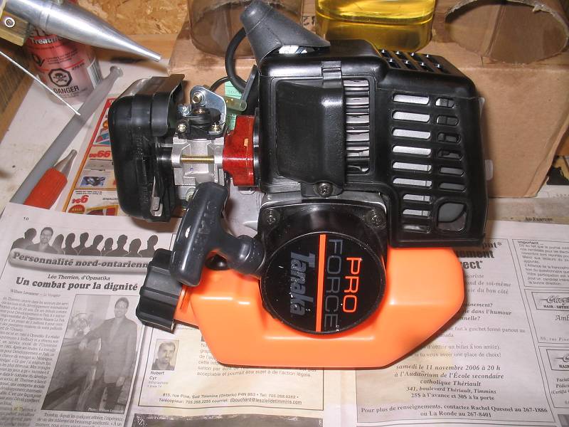

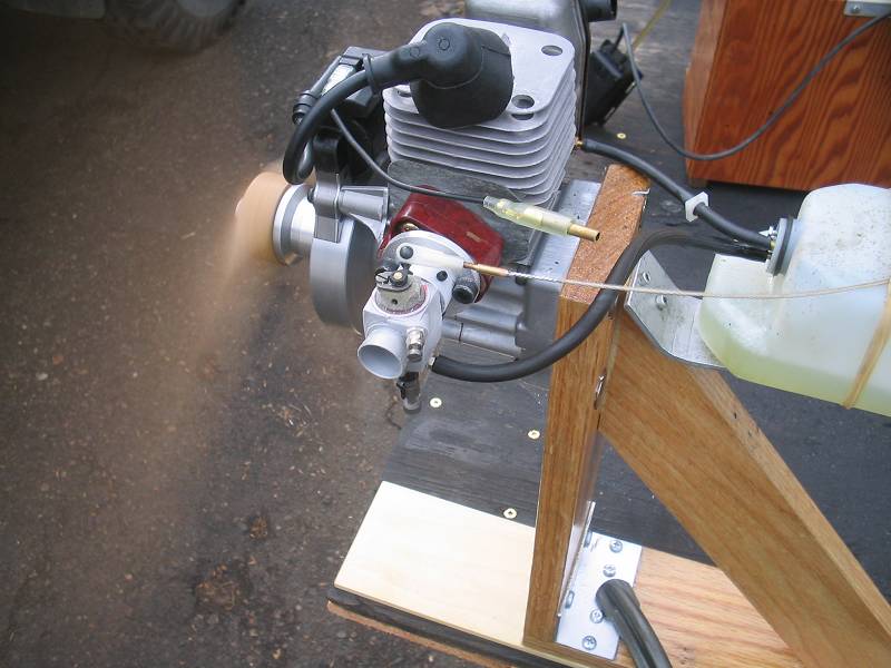

Pictured is before and after on a Tanaka 26cc conversion from their TED 262DH powered drill. Dead nuts easy to do, all I had to do really, was to grind off the front flange bits. Also, I had to trim a bit of a groove to allow clearance of the mounting bolts. Plus the usual trimming of the flywheel and prop hub. I really like Tanaka's four bolt approach to everything. No oddball backplate mounting holes. The neat thing too is that you can bolt the Tanaka directly to your firewall, no mounting plate at all required.
On another thread I asked about the suitability of mounting a spring starter to the rear end. I flew a Quadra when they first came out and am only now going big again. If you look at my past postings, you'll see that I was/am heavily into 1/2A. I'm hoping you guys won't hold that against me. [X(]
Point is, getting whacked by a small engine is annoying. Not so a gasser, I'm speculating. Any advice in this regard?

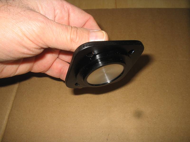

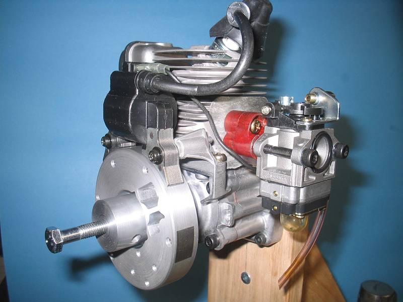

I'm also converting this one to reed operation. It won't be by adding a reed assembly at the side port intake, that has been plugged. The reed intake will be at the bottom of the case.
When I modify, no half measures, I MODIFY.
And as the pictures show, I'll be using a stock, RC throttle instead of the Walbro. This one is off of a K&B Sporster .60 and the bore of both rotary barrels is the same.
I'm very new getting back to big gassers so I don't know the latest. I noticed that the Walbro that came with the Tanaka has a rotary barrel along with a needle that restricts fuel delivery as the throttle is reduced. Very much like our RC throttles although the low speed needle appears not to be adjustable. Is this unusual or is this the norm these days?

The latest run can be seen here.
http://www.youtube.com/watch?v=Q6DKts9o9pI
Now we're getting a proper 1600 to 7000 RPM on a Zinger 18 X 6. Still needs to be broken in.
However, it was found that the idle was a bit rich evidenced by the slight smoking on acceleration after a prolonged idle of ten minutes. So I went to lean out the idle and found that both the main and idle mixture is fixed on this engine.
The solution was to bolt on the carb from an OS .108 along with applying muffler pressure. It worked fine with nearly the same top end but idle wouldn't go lower than 2200 RPM. This may have been due to the below freezing conditions of the day with little chance to do much tweaking. If you look close, you can see frost on the OS carb.
Will try again when we warm up a bit.

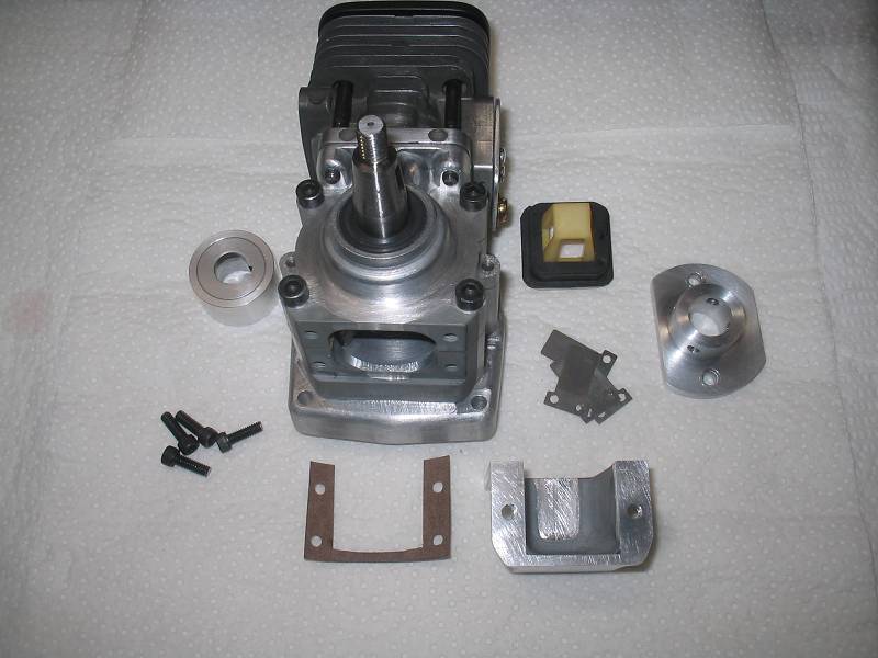

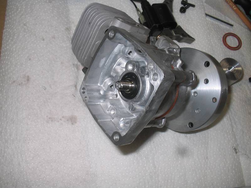

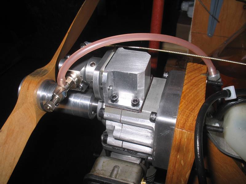

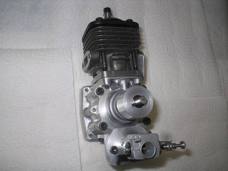

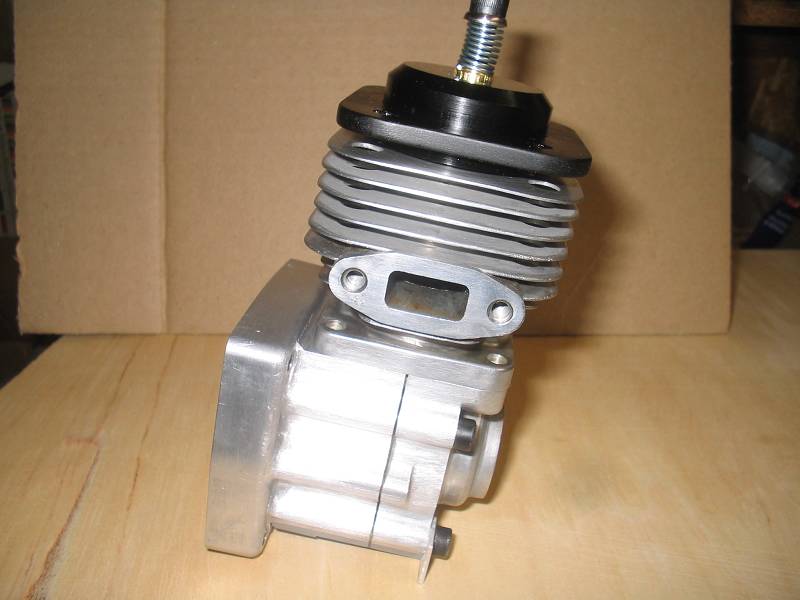

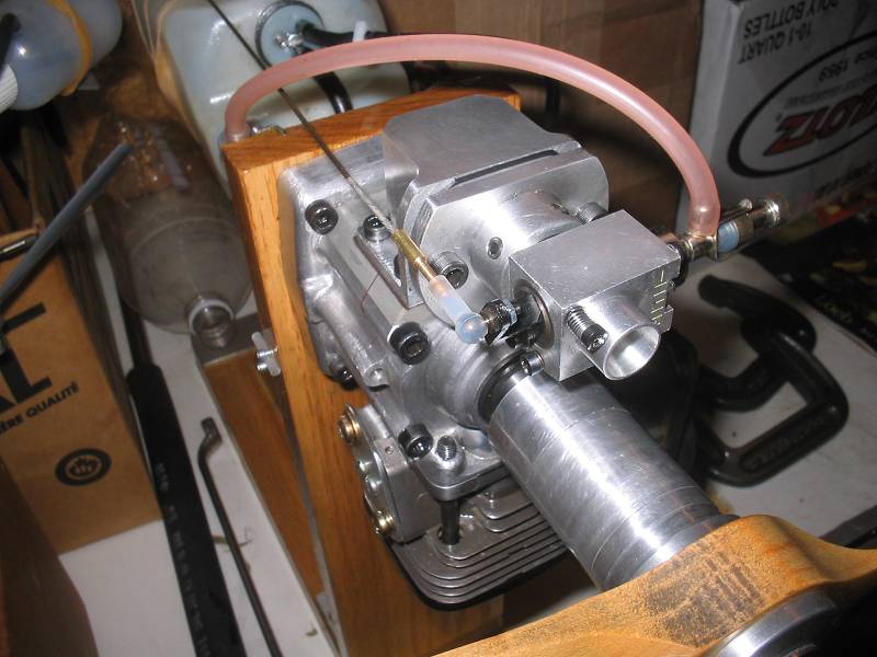

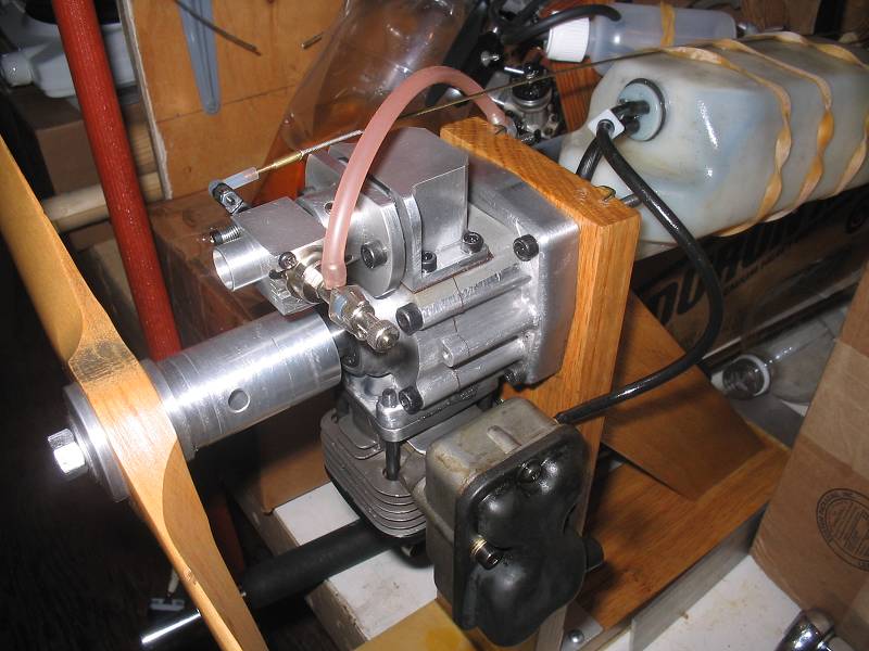

Here, http://www.youtube.com/watch?v=noH_SOBe0YE can be seen the case reed version of the Tanaka 26cc.

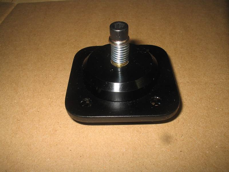

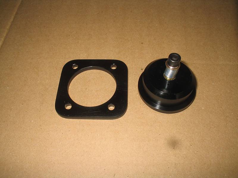

The stock cylinder had the head milled off and a new head button was made that is secured with long bolts that also holds the cylinder down. The head button carries an OS Turbo Plug.
The stock intake port has been plugged and a new, reed intake assembly has been installed to the bottom of the crankcase.
The carb is from a K&B .40 Sportster with a venturi bore of .34" as opposed to the stock bore of .45"
On the baseline, 18 X 6 Zinger wood prop, we are getting a solid, 7500 RPM. That translates into an extra .4 horsepower over the stock gasser on ignition.
We have shed nearly two pounds of ignition gear and gained power at the same time. Can't beat that.
However, we likely would gain that and more, if we could increase the compression ratio on the stock gasser. The real payoff with this conversion is the weight reduction.
Unfortunately, throttling didn't exist. Anything less than 3/4 throttle produced a flameout.
Flipping the engine to a sidemount configuration cured that, interestingly enough. We are speculating that at low throttle, engine suction was insufficient to draw fuel properly. Sidemounting provides for much easier fuel flow to the bypasses for delivery to the cylinder.
The plug is a P8, OS turbo plug. This is their cold plug and was tried in this case, simply because that's what we had on hand.
The head button was made to give us a compression ratio of 14:1 and this has proven to be about right. Decreasing the compression as an experiment will be tried but we don't anticipate any benefits. The runs today don't exhibit any overcompressed symptoms. More productive will be increasing compression to the point of getting some ping. Then we'll back off a bit and proceed to experiment with a bit of nitro (2-5%) along with various plug heat ranges and extra shims.
Pictured is the installation of an Enya, three needle throttle from their .60 which has a bore in the barrel slightly larger than the stock Walbro.
Throttling still wasn't perfect as we couldn't get less than 3K. The stock, ignition engine on gas gave a forever, solid idle of 1.3K So, as a side mount improved throttling, we reasoned that inverted might be even better. Unfortunately, it was pretty much the same as side mount.
Either the reed design itself isn't suited to this configuration, or a reed on the case just isn't a good idea.
Next up will be to install the reed assembly onto the sideport as per the stock arrangement.
