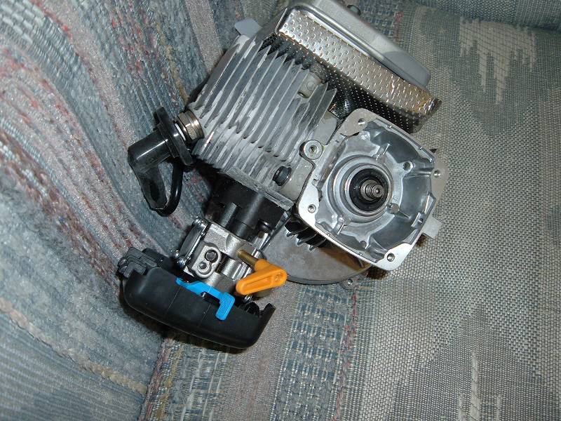

I bought four of the 26cc blower engines advertized on EBAY.
I have not been able to remove the nut that holds the fly wheel on. Is that a left hand thread?
Here is two pictures of the engine with the shroud removed

That engine sure looks like a Mac blower engine. It should not be L.H. Threads. Go to the Yard man engine site and look up MC290...its the same as Mac MB290. Place flywheel in a vise and use a six side socket. May have to heat a little with propane torch to loosen locktite. Capt,n

I have 18 of those engines..The nut comes off easily with my 3/8 air wrench..Thread is 8mm x 1.0 pitch, right hand....The Chinese Loctite material really holds....

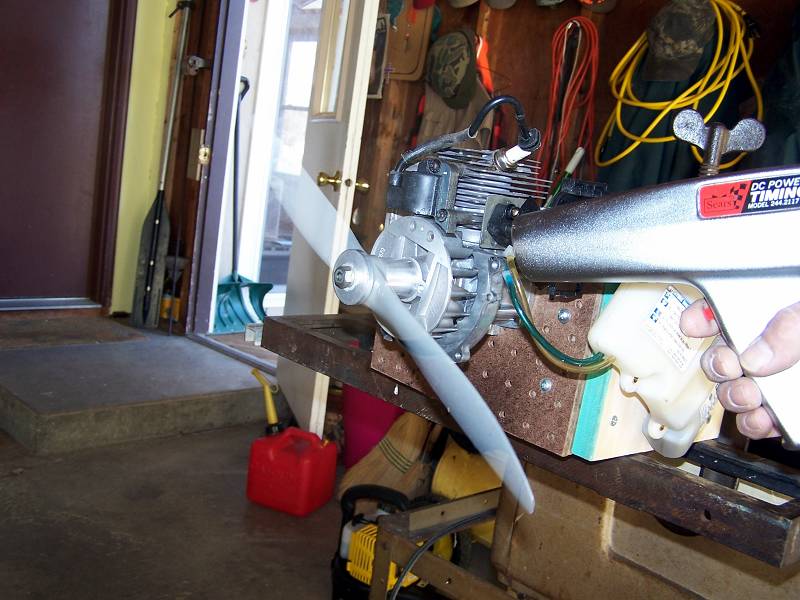

This ia a photo of when I had the Mb290 out of blower. Capt,n

Try heating the nut with a torch. Those engines have a green Chinese threadlocker on just about everything. It's an M8 X 1 right hand thread.
