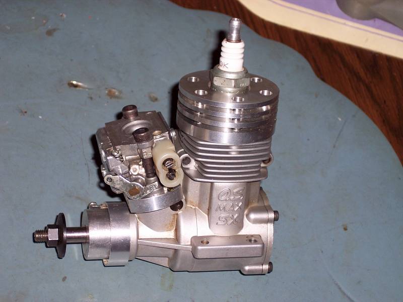

Old 10-21-2007 | 11:39 AM
  #31
Posts: 424
From: Naples, TX
Default RE: Convert GMS 120 glow to Gas
I got this far then moved on to another project, I'll get back to it one of these days.

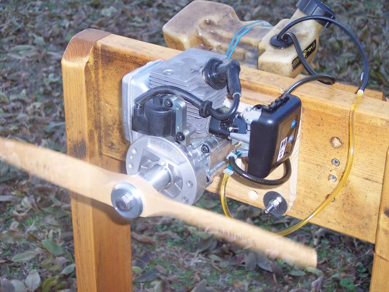

Old 10-29-2007 | 10:02 PM
  #34
Posts: 12,957
From: Hesperia Michigan, MI
flipflop: Are you still running the Mack MB260 engine yet. Mine is taking a heck of a beating in my leaf blower this fall. She screams!!!! Capt,n
