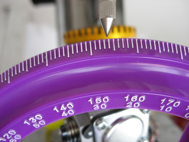

Pictures worth a thousand words.
I’m sure there are a few slow learners like me that could have been confused by finding the TDC. So here is the explanation with some pictures
Based on what I learned form the previous postings.
Pic1, Secured the engine with the vise
Pic2, Take the plug out. Turn the crankshaft until the piston is almost at the top. I used 1/8†rod as a piston stopper in the drill chuck.
Pic3: Attached a protractor to the crankshaft. Hand tight the prop nut. Used Dial indicator pointer to track the reading on protractor. ( The actual dial indicator is not used)
Pic4: Turn the crankshaft counterclockwise slowly until the piston hits the piston stopper. In my case, the piston hits the stopper at 82 degree.
Pic5: Now turn the crankshaft clockwise until the piston hit the piston stopper again. In my case, the piston hits the stopper at 154 degree.
Pic6: Now the TDC is 154+82 / 2 = 118 degree on the protractor is the TDC
For my initial test I set the ignition at about 27 degree before TDC. Therefore turned the crankshaft counterclockwise until the reading was at 91 degree. Hold the crankshaft, loosen the prop nut, turned the drive washer until it sparked. That setting is 27 BTDC.

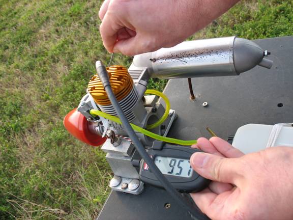

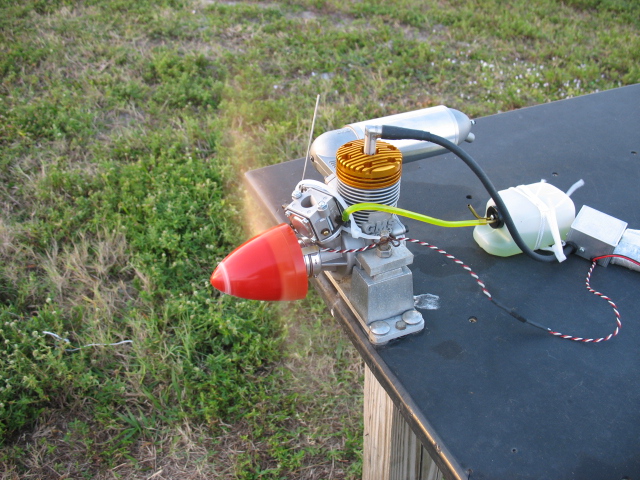

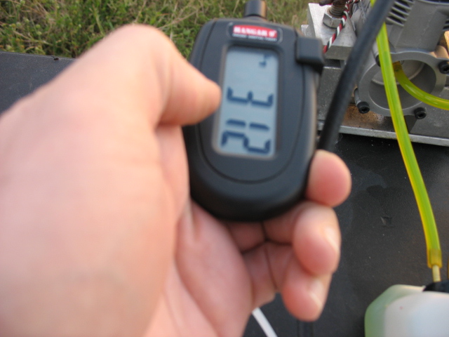

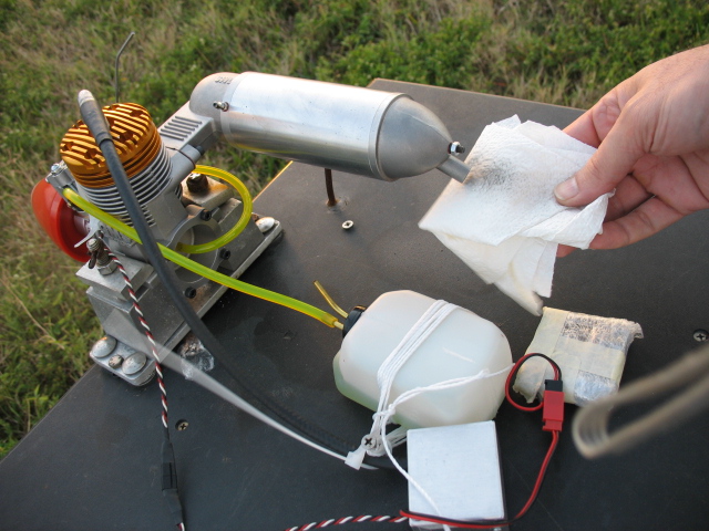

This afternoon I took the engine to the nearby flying field for another test run. Last week I had no luck, the engine didn’t start at all. It looks like the timing was setup wrong at 39 before TDC and I was thinking that I had it set at 27. After I corrected the timing, I was ready for the second test run. Prime the engine and it start it up with a touch of starter.
Now I think I got some tuning to do. The idle was about 3000, which I think it was too high and max RPM was 7740 which I think is kind of slow. Since it was getting dark, did have much time to deal with any adjustment. I ran the engine for about 15 mins.
Now what are some of the steps need to do to improve the max RPM and lower the idle?
Does that have to do with the ignition timing?
Any help appreciated.

Tuning hintsset timing to 30 Degrees BTDC, adjust carb way rich THEN lean for max power using a Tach.
Is your ignition a syncro spark?? Or are you using fixed timing?.
What sized prop? Did you ever get a base line using glow fuel?

The protractor you are using is a little awkward. However, what you want to do is this:
Eyeball the piston at TDC. You can use a rod or something and feel for it, or use a dial indicator. Then set your degree wheel so that the pointer is pointing at Top Dead Center.
Then install your piston stop. Rotate the crankshaft so the piston touches the stop and note the degree reading.
Rotate the crank in the other direction until it touches the stop and note the reading.
If the readings are exactly the same, you lucked out and set the degree wheel properly by chance.
More likely, the readings will be different by a few degrees. Let's say one reading was 44 degrees before top dead center, and the other was 50 degrees after top dead center. Move your pointer or degree wheel to half that distance. (In other words split the difference and move the wheel or pointer 3 degrees.)
Now rotate the crank in both directions and note the readings again. They should be equal, or very close. If they are off a bit, adjust the wheel or pointer again. You want the reading to be the same each time the piston touches the stop.
When you have achieved this, you can remove your piston stop, and now when the pointer/degree wheel indicates zero, or TDC, the engine will be at it's true Top Dead Center.
You can then set your ignition timing, check your port timing, etc.

Today I readjust the timing to 30 BTDC from 27 BTDC that I had on my previous run. The RPM improved about 1800. The prop I'm runing is 14 X 8.
The idle still too high at around 3000 PRM, any idea what should be the next adjustment?

RE: Convert GMS 120 glow to Gas
If you are sure the throttle is closing all the way, then it's another problem. Does the butterfly in the carb have a little hole in it?? Not the choke, the throttle butterfly... If so, you will have to solder it shut.
If that's not it, then look very carefully at the carb butterfly, and see if it has a "v" shaped groove, or a small, half moon shaped cutout at the edge of the throttle butterfly. If so, you may have to find another carb that doesn't have that little cutout. It makes an engine idle a little smoother and transition better, but on small engines it can let too much air pass and cause a high idle.
If it's none of these things, it has to be an air leak. Your manifold adapter, gasket, or something is allowing air to get in and causing the high idle.
