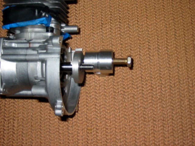

Posts: 12,957
From: Hesperia Michigan, MI
Default RE: echo 22.8 cc gas engine
newguy05: You do not need to remove flywheel to place prop on engine. Just add a prop adapter...then prop. In the added photo the part on the crankshaft is the center of the flywheel. I am going to do the 2nd engine with stock flywheel ignition. This one is for Gas/glow or electronic ignition. Capt,n
Old 08-08-2007 | 11:48 PM
Joined: Aug 2005
Posts: 72
From: bloomfield , KY
where is the best place to get one or instructions to make one easily, im 17 with no job so im tryin to make do with what i have. thanks
