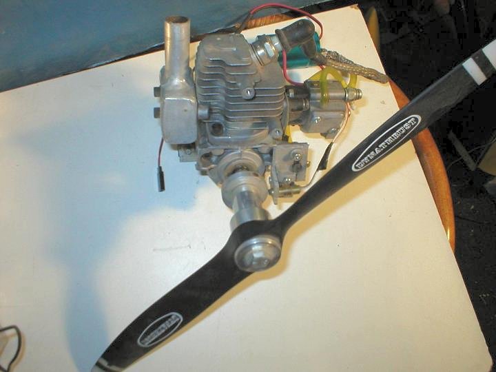

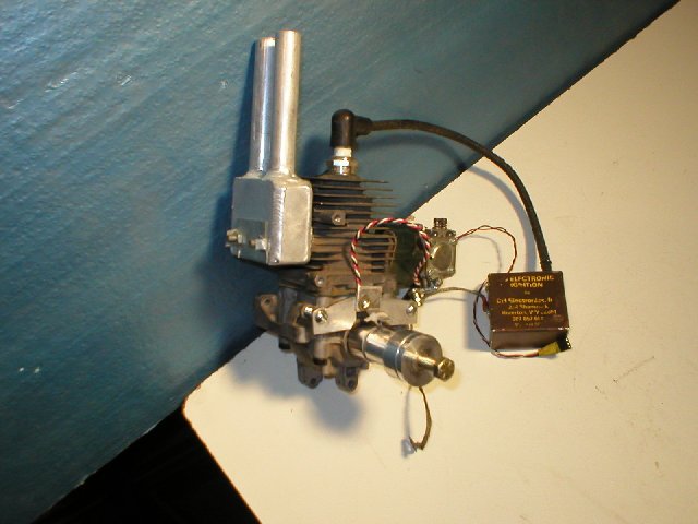

Just make your engine look like your spe.Heres a pic of my echo 24cc and my stihl 28cc.just copy them.I make my own prop hubs now.The mufflers i bought from lambertsrc or i just gut the stock one.I did a toro muffler and it only took about 5-10 minutes total time to take apart,gut,and put back together.No brazing,welding,soldering or anything.Just unbend the edge,gut,then put back together and flatten edge with hammer.
