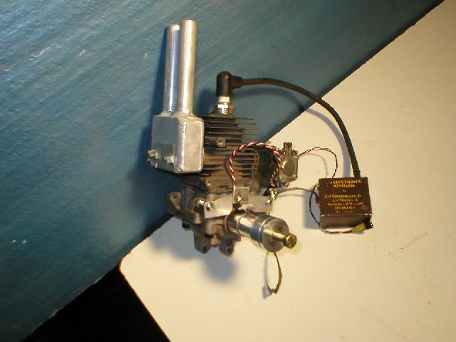

I just about only convert echos and stihls now.Heres a pic of my 24cc and my 28cc stihl.both of these engines weigh 3lbs rtf with ign.
