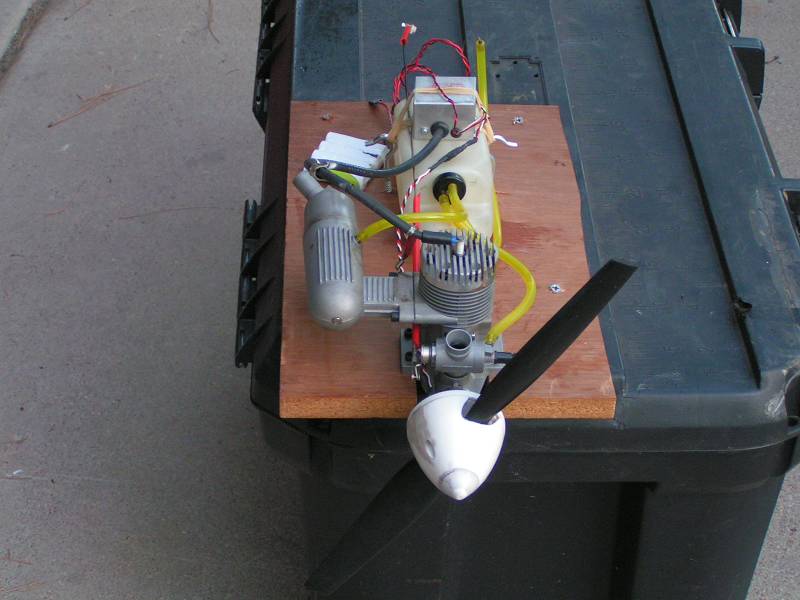

I think I just dropped the cost of my RC addiction way down over the long haul. Today I converted an ASP 1.08 glow engine to run on E85 biofuel with 18% castor. E85 is available here at about 7 gas stations, and I bought two gallons yesterday for $1.99 a gallon. I used the stock glow carburetor. Since E85 is 85% alcohol, there's no need for a gasoline carb. I added a CH Ignitions spark system to the engine. I installed the spark ignition by drilling a small 1/8" hole/recess in the prop drive washer and installed a tiny 1/8" diameter magnet, added a Hall Effect pickup with hose clamp and timed it to 30deg BTDC per the CH Ignitions instructions, replaced the glow plug with a 1/4-32 spark plug, and connected up a fuel tank with gasoline lines and stopper. Connected spark lead to spark plug, and switched it on. It runs really smooth, and all I had to do was lean the top end 1/4 turn and the bottom end 1/8 turn. The needle wasn't as broad in adjustment as 15% nitro, it was about like FAI fuel, two clicks either side of peak. I think I could run my Raptor 50, my Saito 120, and Saito 90 on this stuff. I am running E85 with 18% castor oil. I wonder just how much castor oil I really need since the 15% gasoline has more lubricity than straight alcohol. I have found a source of beauty supplies on the net that sells castor for $10 a gallon, I'll give that stuff a try. The exhaust smells really good, like straight castor glow fuel. I know it all sounds like a lot of work to beat the cost of glow fuel, but I'm just sick of paying for glow fuel. Maybe I'm a future gasser, but I really don't want to go giant scale and I have all these glow motors. The break-even point isn't that far out on the investment in the ignition module. My tach broke yesterday, so I'll update this with some hard RPM numbers when I replace it. I did get some head temps, they were about 250f. I wonder how much castor I really need with this setup. The 15% gasoline has more lubricity than the usual methanol/15% nitro mix. I tried some 12% castor E85 mix, but I don't know how the conrod's bottom end will do on that. Can someone explain to me why the glow car engines can run on 10% oil? They are revving high with less cooling than an airplane motor, but just a bushing on the lower end.

Today I converted my Saito 120 to spark ignition and E85. The Saito carb is fine on top end and idle, but midrange is very rich. I think these Saito engines were set up to use high-nitro fuels, up to 30%, so they flow lots of fuel in the midrange. This leads me to think that an engine set up for FAI or moderate nitro would work better with the E85. I need to change the spraybar profile a little in the midrange. I know it's the mixture because I can pinch the fuel line and smooth it out. I soldered the hole in the spraybar closed, and then opened it back up again with a little smaller slit. The Saito spraybar is very difficult to work on, I couldn't get it out of the carb body to save my life. I resorted to scraping at it with a sharpened screwdriver and hobby blade. We'll see tomorrow if that is better. I know it's a lot leaner in the midrange now, maybe too lean?

Update on the Saito 120 E85 conversion, my carb modification worked. I closed up the low end of the spraybar with solder and reopened it with a much leaner profile and now it transitions nice, runs smooth in the midrange and ok on top end. The idle is nice, it's very lean and varies a little bit, but definitely flyable all around. I can't wait to try it out.

E85 fuel consumption is less than glow fuel and more than gasoline. The difference between glow fuel and gasoline is almost a 2:1 difference with E85 falling in between them, probably closer to glow fuel than gasoline. On full size cars, there are differences between FFV's regarding the efficiency on E85. I met a guy last week that gets the same mileage on E85 as he does on gasoline on his new Ford F150. Maybe it wasn't very efficient on gasoline to begin with, and it is more efficent than the average FFV on E85, and the two things evened out his mileage on each fuel? Theoretically with the lower energy content of E85 it should take more volume to make the same power. We are at 6800'MSL up here so maybe that made his truck less efficient on gas? At the time, gas was 2.67/gal and the E85 was 1.99/gal so the difference to him is dramatic, on the order of spending 34% less on a fill-up for the same mileage.

I just tried my first E85/glow fuel mix on glow plug with good results. I mixed E85 and 15/16 Powermaster glow fuel at 2:1 ratio then added 7% more castor oil. In an ASP 108 I was able to get a smooth top end, and a decent idle, about 40 seconds. Transition was ok but sometimes cut out if I accelerated fast from idle. With the glow ignitor on, idle was perfect, and transition was perfect. That final mix was 4.7% nitro, 22.2% methanol, 9.5% oil, 54% ethanol, and 9.5% gasoline. I just realized I didn't add 7% castor, I added like 5%, a miscalculation I'll correct on the next batch. When my tach gets here I'll put some numbers to this. I have a feeling this E85/glow mix isn't far off what I was getting with E85 and spark ignition on the ASP 108, and that motor ran perfect on spark. Can someone tell me what their experience has been running alcohol in the spark gassers? I have always heard a bit more power is obtained than on gasoline, and vice versa when converting glow to spark with gasoline. I guess the alcohol just vaporizes better? -Tom
