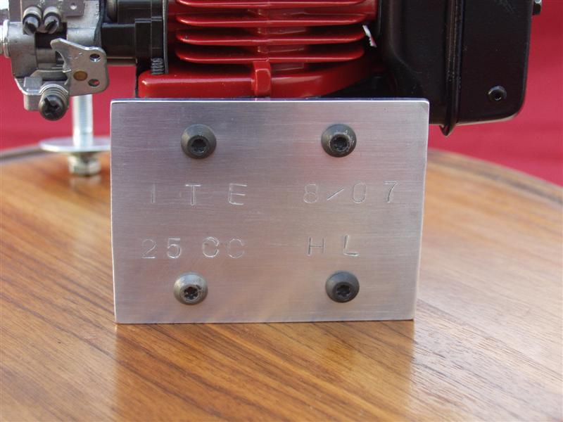

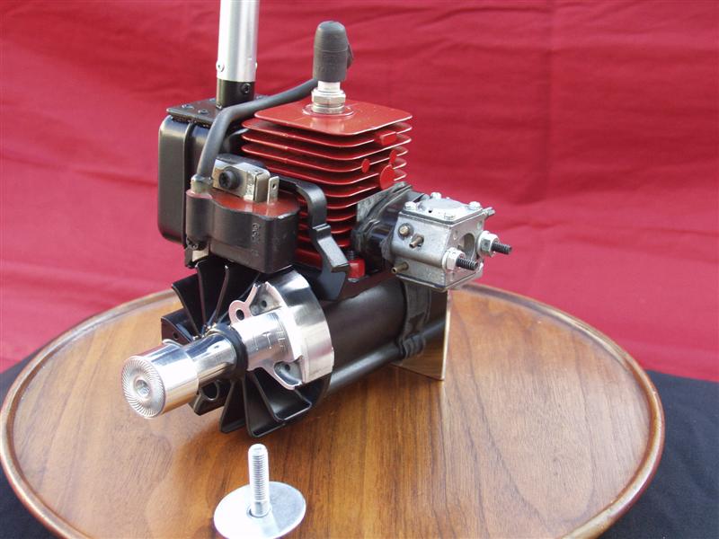

Yes it is 25cc's and you will need the standard 5/16 X 24 tpi thread adapter or hub. A 3 X 4 inch T6 aluminum engine mount 1/8 inch thick would do fine. The one pictured below is a conversion I sold awhile back and it is a good example of a finished Homie 25. Hope this helps.

ORIGINAL: andernamen
ITE,
What did that Homey Weigh?
If I remember correctly it was around 3 lbs 11 oz or so.

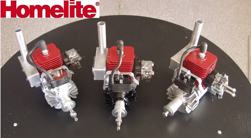

The below pic shows lighter versions but im having trouble getting more aftermarket muffler blanks these days.
