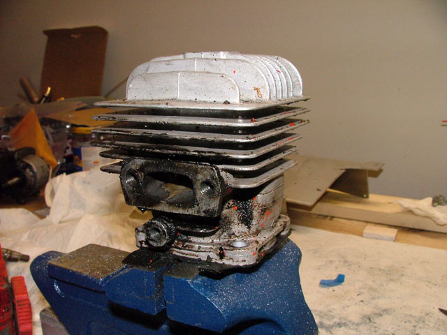

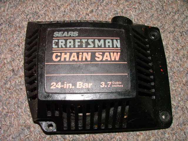

I got a 3.7 cubic inch craftsman saw on ebay. It looked good until I got the piston out of the cylinder. Something got inside and completely destroyed the piston and cylinder. Does anyone recognize this cylinder as another brand? I would like to find a replacement. The pullstart cover is the only identification I have for the model. I'm hoping the collective RCU mind can come up with something.

It is most likely a 3.7 Poulan Saw. If you scratch the red paint...there may be green paint under. Do you have more photos? Capt,n

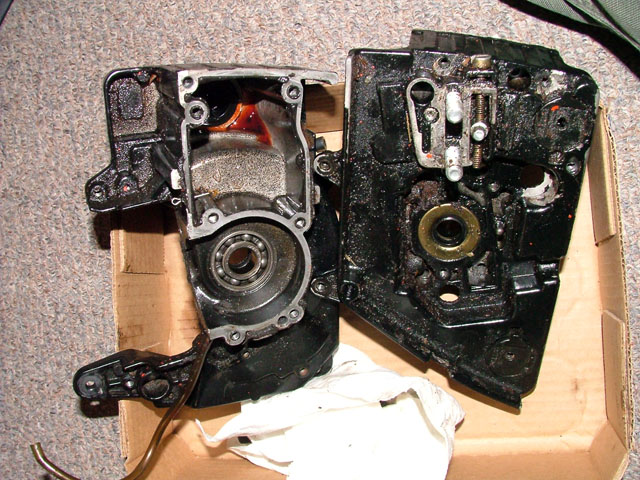

The red paint is not from this saw. That is an old homelite. The crankcase is part of the saw. I would have to cut it down. You can see the damage done to the piston. The cylinder looks the same inside.

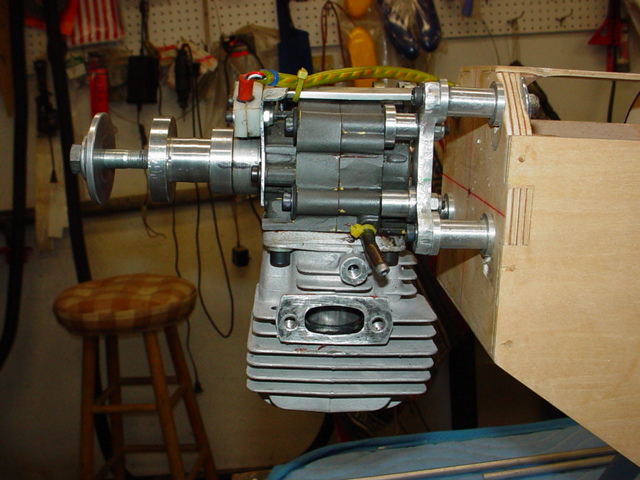

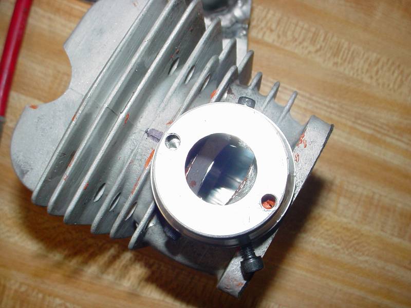

that is a poulan 60cc I have several and I bought all the new piston cylinder kits I found because they did quit making them.

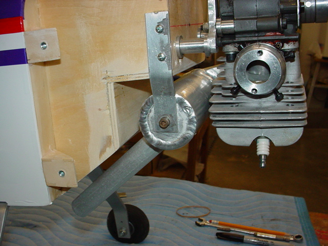

I am flying one on my wild hare edge, the crank on the 60 and 54 are the same but the piston and cylinder are totally different and won't bolt to the same case
