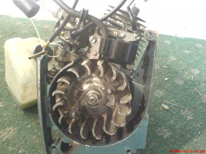

Old 11-14-2007 | 07:59 PM
Posts: 12,957
From: Hesperia Michigan, MI
Default RE: 41cc homelite XL-1 gas glow conversion
CAN YOU POST A PHOTO WITH THE RECOIL OFF? THANKS Capt,n

yeah sure captin
and ki8fer,
i made the adapter from some steel bar stock in the lathe, no taps at all!!!
shaun

i will get the pics for you tomorrow captin, fogot the camera today.[]

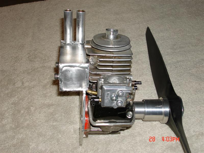

Shaun, this engine looks identical to the one I just converted to Gas\glow. Mine came from
a Super EZ saw. It measures 41.? CC and has a 4 reed intake. I broke a ring when I took
it down so I put in Bowman rings. Seems to have very good seal. Need some good weather
to run it. I tried to upload a picture, but it doesnt seem to accept it.

from what i have heard,
the super eZ and the XL-1 have the same engine
i'm going to get thoes pics now.
shaun
