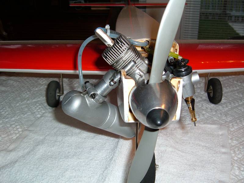

Second try, My ST 51. The engine was modified for another purpose. STOCK out of the box + gas and go. An Evolution and the ST.

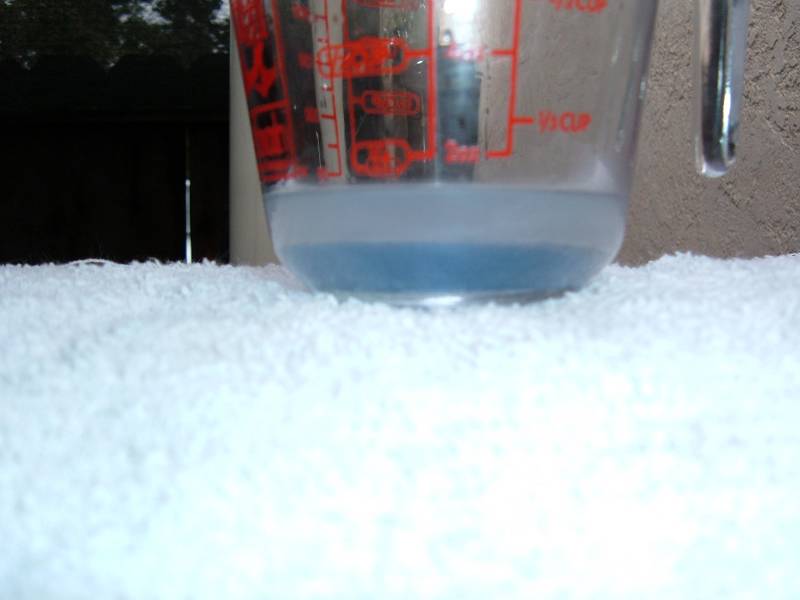

3- used the 33/66 mix. The fuel looks like it is trying to seperate.

What's going on with that mutant engine! I can see a plug cap, some strangely angled fasteners around the back and a carb set at a jaunty angle. Please explain - with more piccys [8D]

I've been doing Gas/Glow for quite a while, and I've never had fuel separate like that. Try a different brand of gasoline.
Gasoline that has water in it will do this too. The water combines with the alcohol in the glow fuel and separates out.

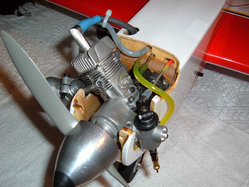

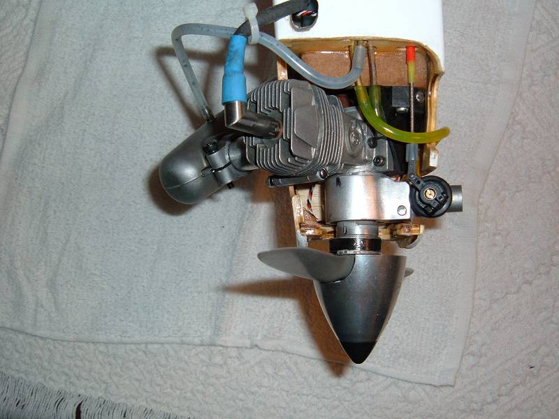

As to the ST 51 Mutant, I like that! The short of is that I turned down the front of the engine and made a manifold for a Walbro to run gas. The manifold was not aluminum, but some unknown composite. It failed. I decided to put the stock carb back on so I cut a new adapter out of aluminum. I offset the carb for the "Coolness factor" and because I wanted to see if the carb mounted in a plane with the needle at tank center would make a difference. Kinda like side mounting an engine but this time only the carb. This is part of the "Muffler pressure with gas question". Tank center line etc. So far I think a long pressure tap with maybe an aluminum tube would cool any gas problem. Tygon will not handle the heat, so Silicone to aluminum? Ch ignition with Syncro spark as mentioned earlier on gas and 20% synthetic oil, the same fuel as the gas mag ignition evolution in a previous picture. That's the short version? The mount mess is the adaption of the ST mount to the Weedeater mount that was in there first.
the only ST pictures I have.
