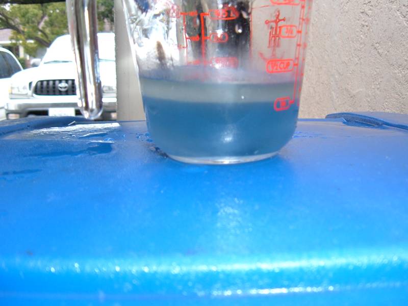

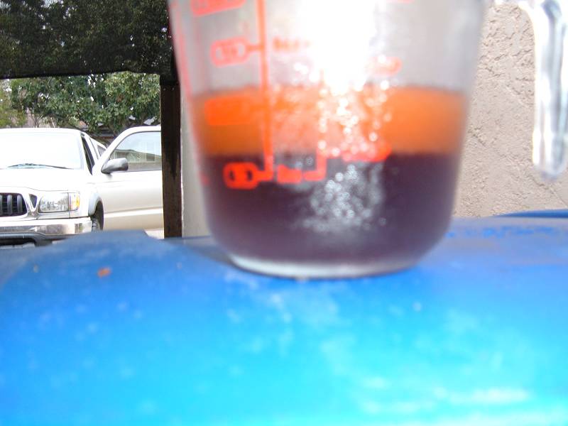

1, The adapter for the ST has a channel cut into it. The channel goes to the stock intake (center in front of the cylinder). JB Weld holds it together. The adapter is actually two pieces interference fit and JBW. The first intake allowed fuel to collect in a cavity that has been filled by the "second Piece". It took several seconds for the engine to respond because of the fuel collected in the cavity. As I mentioned before this engine runs like the Stock version.

Traxxas is what i run. It is the only fuel I can find out here that is 10/10. I have never had my fuel mix do that. I think there has to be water in that gas.

Got new gas, name brand. Same result. I mixed Redline oil into the mix after it seperated to see if something would mix.

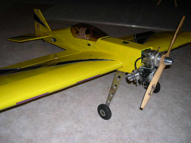

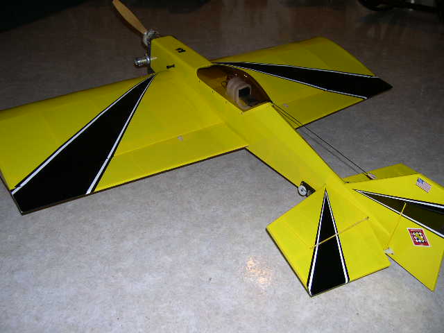

.40 size plane (Twist) on gas. 21 cc Featherlite, C&H ignition, throttle coupled spark advance. 50:1 gas:synthetic. Hovers at 1/2 throttle. Flies 12 minutes on 4 ounces of fuel. 3 seasons and ready to go again. CHEAP fun. Joe

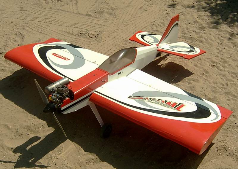

The Twist is made by Hangar 9 and available through Horizon Hobby.
Actually, there are 3 of them. I have the Twist 40 with a Fox .78 engine on it. (A rocket!) I also have the Twist 60 with a Super Tiger .90 on Gas/Glow on it. Then they also make the Twist 150 which is designed for Glow or a 26cc gas engine.
The Twist shown in this thread is the .40 version. They are fun planes, but have a weakness in the fuselage. There have been problems with them breaking the fuselage at the rear edge of the canopy where the fuselage is the thinnest. I never broke my Twist 40, (knock on wood!) but I broke my Twist 60 fuselage twice. I finally laminated 1/8" ply with epoxy onto both sides of the fuselage in that area, and no more problems.

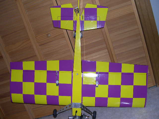

Hi ya Guys, It's Hangar 9's .40 size Twist 3D. Box stock except for the engine. No beefing up anywhere. Ignition and ignition battery in the fuel tank compartment. Fuel tank in the receiver compartment. Receiver and receiver battery under the casnopy. No lead anywhere and it balanced. The thick airfoil makes it handle the little added weight. Radar gun sez 81 mph flat out. With throttle management it can descend to land VERY slowly. Near vertical descent, with slight forward motion. I took off the stock design trim. Looked to toylike. Black sunburst on top with yellow checks on the bottom. Very rugged, has held up well for 3 seasons and ready to roll next season.
