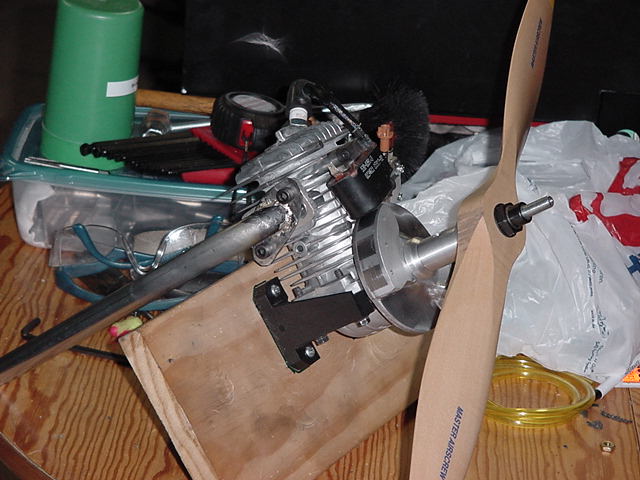

h82crash's Avatar
Posts: 841
From: ramona, CA
Default Carb Spacer
Just a pic of my conversion.

Old 04-15-2003 | 02:20 AM
h82crash's Avatar
Posts: 841
From: ramona, CA
Default Carb Spacer
Another, Hope my braze holds.

Old 04-15-2003 | 01:11 PM
Panzlflyer's Avatar
My Feedback: (15)
Posts: 1,960
From: Goldsboro, NC
Default Carb Spacer
Looks good.
I think the support at the ends of the pipe is going to be the most crucial
