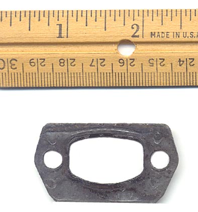

Hi Al; Here is a scan of the Poulan 46 gasket for the header. I used 1/4 thick 6061. The holes are .250 dia. The center to center on the holes is 1.450. The width of the port is 1.000 and the height is .650, of course the odd shape
If you could crank out some flanges I could make you up a header or muffler or???
Thanks; Adam

Hi Adam,
Sorry for taking so long to get back to you. I was trying to wait and see when I can schedule my next trip out to my buddies shop. I will make a few of these manually and see how they turn out and let you know.
Any questions just contact me offline.

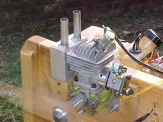

Ken Lambert made this one for my Poulan 60 yesterday. Works great! Tig welded, a little more volume than the Abell or B&B mufflers to let the engine breathe a little better.

it's not hard if you know how the hardest part of it is parting with $2000. just to make a few mufflers for conversions,the welding itself just takes practice
