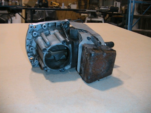

I am planning to convert a 32cc Engine I got off a weed whacker, and am wondering if anybody has moded this type of engine and what success they have had. The tag says that the engine is Sears, Roebuck and Co. but I don't think that it is the make of the engine.
Here are some images to help.
Jonathan
{EDIT}
Here is the information off the side of the weed Whacker
Sears, Roebuck and Co. USA
2000 US EPA PH1
Family: YPWES.0324LT:EM
DISP. 32CC
Model 944.510560

Can't be sure, but Sears has typically used Tecumseh 4 strokes and Poulan 2 strokes in their own-branded equipment. My bet is on poulan.

Looks like a Ryobi 31cc long shaft, I converted one with the short shaft with a conversion kit from a guy in Florida that machines them. Ran good with an 18x8 prop.

That is definetely a Poulan 32. They are a bit heavier than a ryobi. They have chunky big cooling fins and a full length crank that adds weight.

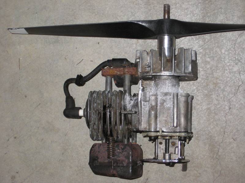

I might have said that backwards, I meant something like what is attached, you're not spacing the flywheel out, you're putting a spacer between the flywheel and the prop to get it spaced out enough to put a nut on the end of the crankshaft holding the prop on, it's a simpler prop hub than most other conversions in that it doesn't need to be threaded all the way through, just needs a hole...
I just re-read what I said last night, I started at the prop nut and worked my way to the engine, while you were thinking about it the other way... figured a picture would help more anyway also, on indiana's poulan engine gallery, page 5 and the first image on page 6 is one of these engines converted

Ok thanks. I thought you might have worded that backwards. I found the other picture too. It looks good and simple enough too. Thank you.
