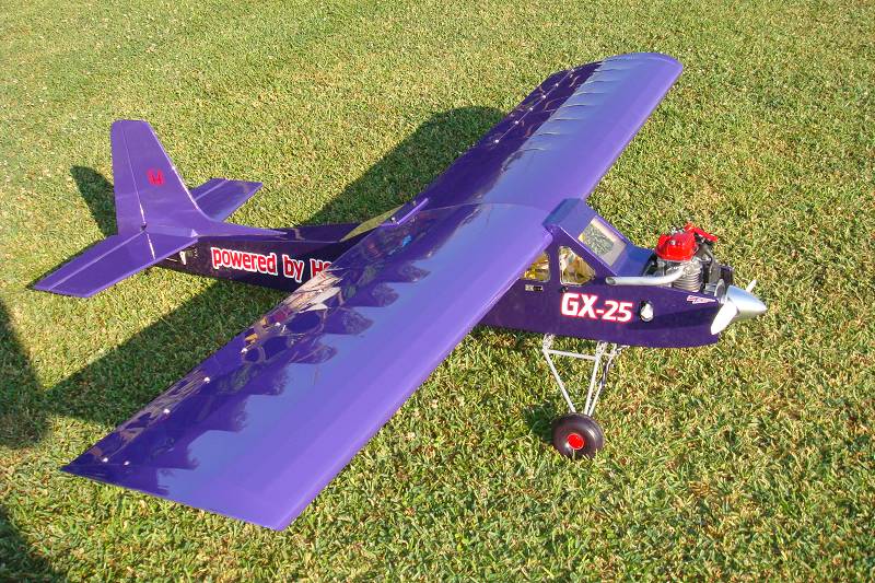

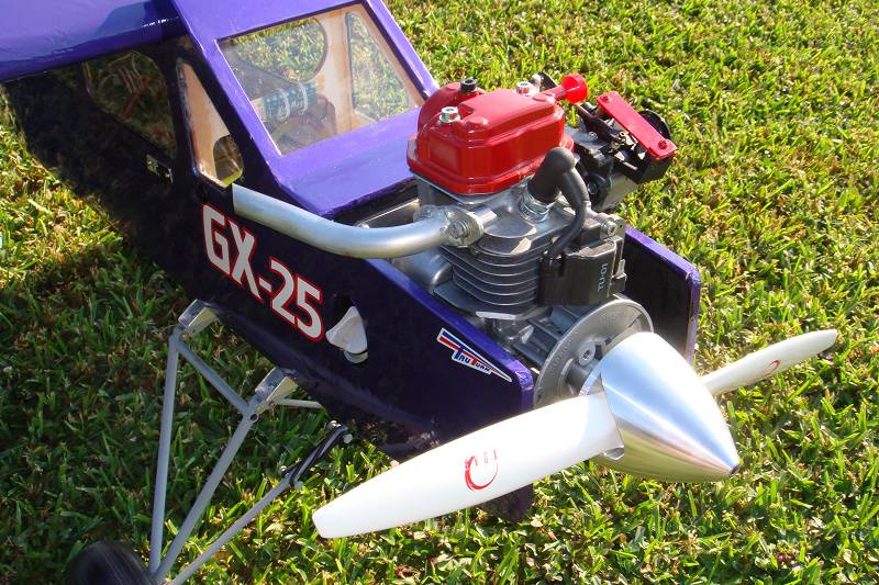

searching threads on the Honda GX engines and thought you guysmay be interested in my plane and engine.
It is the GX-25, swings a 16x8 at @ 6800 and flys the 14 lb plane pretty well.
I am going to try the GX 36 next.
FYI, the plane is a kit by AMR in Canada, highly recommend them as a supplier of kits, engine was $199 and conversion from CARR precision was $75 (the muffler was home made and red valve cover was just because because)

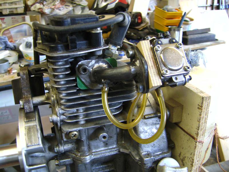

I could do with something like that to use as a test bed for my 31
I got brave and put my mechanical tacho on the prop nut........... it's a different hand carved prop 18" X 8" WW1 style profile but I cannot get it to swing any faster than 6100rpm. Perhaps it will unwind a bit in the air or maybe try a 18" X 6"
I have also made a manifold to get the carb inside my intended steed the SE5a and the prop awaiting stain and varnish (see below):

That manifold is half the problem and those butterfly carbs never work right either. In addtion to the fuel discharge holes being off to one side of the carb bore, they are also on the short side of the intake you made and fuel drop out is a strong possibility. I don't see a transition area for the bore size to match port size.Most butterfly type carb have a large throttle bore that need to transition to the port size, the angle of the transition shouldn't be more than 6 degrees (included angle)
A better solution would be to shorten the stock manifold and use the WY, even though not ideal.

Thanks for the post Nosedragger.
The head has a port of 1mm, manifold is 10mm inside dia, my butterfly is IIRC 12.5mm, the transition taper is only in the ply isolation block which is 10mm. I overcame the impulse port issue by adding a nipple to the manifold and drilling the Walbro to accept another nipple, a small length of Tygon connects them up and it pumps very well.
I'm not familiar with "Fuel Drop Out", by that do you mean fuel spat back out of the induction venturi? I had quite a bit of that at full throttle with a butterfly of 14mm dia, the current carb appears to be performing much better, idle at 1100rpm, throttling instant to 6000rpm and returns back to idle very well.
I have noticed no drop in performance with my home brew manifold over the stock one. I binned the original carb, the barrel type as I screwed it up trying to lesson the return spring tension, I am very reluctant to go back to a barrel carb especially as I would have to buy a new one as my local garden machinery place has no 2nd hand ones with needle adjustment.
I am keeping my eye out for a Walbro with a smaller butterfly and twin needles but they are hard to come by 2nd hand........... I have a non existent budget to work with.
Could my rpm issue be the difference between a 8" and 6" pitches?
I have the stock exhaust on, that may be another source of restriction?

Fuel drop out is caused by the air fuel mixture slowing down while traveling in the intake.The inside radius of the intake could cause that.
If the performance now is that same as with the stock carb, its probably not a problem.
The only time the stock muffler is a restriction to be concerend with, is if the spark arrestor screen is clogged. We have gutted them and all it does is make it louder.
Don't waste your time looking for a buttefly smaller than 12.5mm, if you do find one the venturi will be too small.
9.5 -10mm is about right for a GX31, any larger is a waste because the engine can't use it and the vacuum signal in the venturi gets weaker as you go larger.
If you try a straight pipe on the exhaust make the inside match the opening at the exhaust port face and leave the pipe long, paint it with cheap spray on paint, run the engine (without prop) until it burns the paint off the pipe close to the engine, where the paint stops burning off is the shortest you want to cut it.

ORIGINAL: Nosedragger
"According to Reivers', that gives about 12 lbs of thrust and 1.5 hp. (Master Airstirrer prop used as basis for calculation)"
which I would have thought plenty to pull around a 80" SE5a?

As part of our R&D we found that the intake and exhaust ports were terrible.
It looks like they used a ball mill to form the ports. They machined two holes at 90 degrees. The outside radius is OK but the inside is terrible. We removed the valves and used a small ball mill in a Dremel and cleaned up the inside radius a bunch. Doing both the intake and exhaust gained us a 100 + RPM

The venturi can be drilled out and re profiled to suit, I have done it with good affect in the past but perhaps not suitable for the GX31.

I have no flash kit, just a pillar drill but it's worked well in the past. Since my last post I have flown the Honda with several props on and I have found it to prefer the nasty nylon masters! It's had a Menz 18x8, home carved 18x8 (broad blade) Menz 20x8 and a master 18x8. The master spun aster and produced more thrust than the Menz. It flew in a 91" Volksplane VP1 and flew it in a very scale manner needing a slight dive before looping but would roll from level easily. It's a heavy bird so will be tried in a 1/4 scale Sopwith Pup next which is light. Engine hand starts easily and never missed a beat in any attitude.
