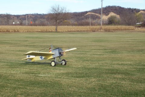

#81
Joined: Feb 2008
Posts: 128
From: Macedonia , IA
heres a picture of my giant Eindekker. Its a foammy 104" wing span and alot of fun I just installed a 3000 super tigre to replace the 2000 that was on it and didn't fly the plane very well.Haven't weighed it yet so don't no how much it weighs.

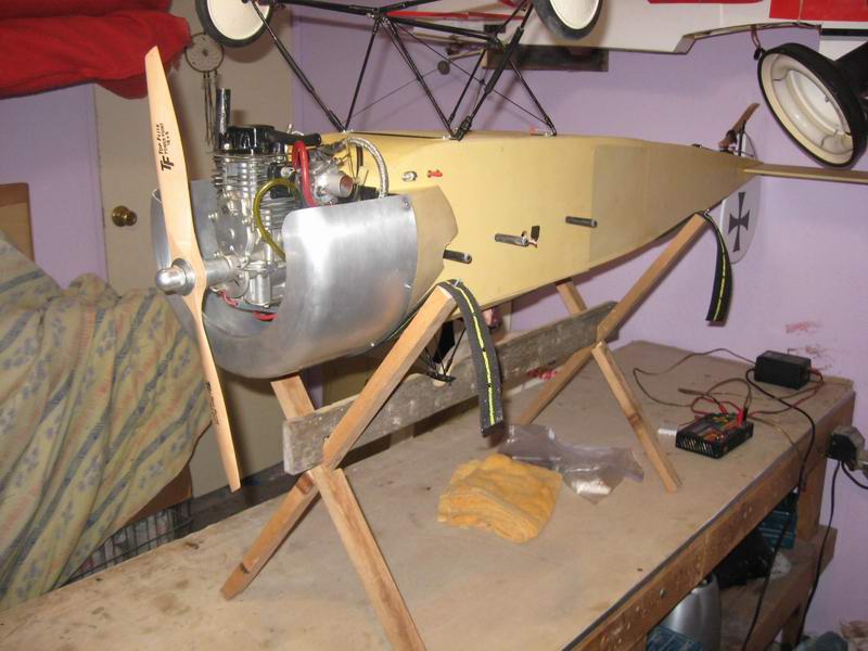

Giant Eindekker/Honda GX31 update.... I was just out flying my Eindekker/Honda today. Since the engine is pretty well broken in now, I was trying to get the carb settings nailed down, but I was having problems getting the carb dialed in perfectly. Some of you may recall I am using a WT type carb. It acted just like one does when the cowl is pressurizing the regulator vent hole, but I had that vented to static air via a tube and hose. Finally, when I was just about to give up and decide that it really needed a WYK type carb, I noticed that when I had my hand near the carb, the mixture changed. I didn't expect much in the way of "stand off" or "reversion" with a four stroke, especially one with no overlap in the cam timing, but I had put a 1" velocity stack on it to straighten out airflow into the carb none the less. But even with the stack, there was a difference if my hand was near the carb. So I allowed for that, and set the carb accordingly and flew it again. Perfect!! When my hand was near the carb, it would lean out and I was consequently setting the carb too rich. It sounded ok on the ground, but would go blubbery rich in the air. Once I set the carb without my hand nearby, (I modify my high speed needles with a "t bar" so that I can adjust them by hand), it was fine in the air.
So, if you are having problems with tuning the Honda, try a longer velocity stack, perhaps a 90 degree velocity stack turned rearward, or just tune yours like I did mine.
Also, I went from an APC 18 x 6 to a Top Flite wood 18 x 6. It just looked so much better with a wood prop. But there is no doubt, the APC is a more efficient prop. The plane definitely lost performance with the Top Flite, though it still has adequate power for a good climb, loops from full power level flight, etc. Yeah I know, get a Zoar or other quality prop.... but the nearest one is 250 miles away!!
Lastly, running the engine inverted, and having it sit inverted between flights is no problem at all. However, while in storage quite a bit of oil does drain down into the spark plug area. I take my spark plug out, and a good bit of oil was lost after sitting for a week or two. So I made a stand to store mine with the airplane inverted and the engine "right side up".
