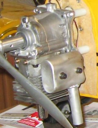

I'm re-doing the the muffler.
Extending the stinger, slanting it back at a 45 degree angle and increasing the diameter 1/8th of an inch.
Perhaps this will help keep the plane a little cleaner and build some low end tork.
The stinger didn't extend far enough past the firewall.
I ended up with a lot of black goop on the bottom wing.
This the before picture.

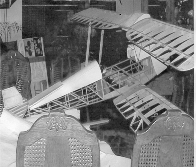

A friend is building the SE5a kit from Dyna Flight and were planing on using the 25cc poulan in it.
It actually has shorter wings than my Tiger Moth.
The Cowl is very narrow so the rear Carb and Exhaust is a perfect fit.
I hope the Poulan performs as well as my Toro does.
