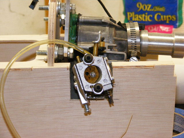

I noticed last night that the setup I have to hold the sensor in place is not working out too good. The sensor I used has the output wire coming out of the top. I ran the clamp over the top of the wire to hold the sensor. Now the clamp has rubbed the insulation off the wire and is shorting out the sensor. I put electrical tape over it but not a good solution. I need to find some way to mount the sensor to the clamp from the outside. I have thought of using epoxy to mount it. I can always adjust the timing just by moving the clamp. But was wondering if you guys thought the epoxy would be strong enough to hold the sensor to the clamp. Or if you guys have another idea.
Jim

Well as it turned out, wrapping anything around the sensor moved it too far away from the magnet to work. So I just tried using 30 minute epoxy to glue it to the clamp. Seemed to work great. Cant pull it off if I tried. Looks much neater too. Good spark as well. Time will tell how it holds up in the air though.
Jim

Here it is mounted in the SE5a
