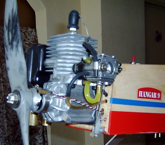

One goes on top of the Carb. and the other can go to the manifold or crankcase.
On top of the Carb. is a raised round spot with a dimple in it. Drill and tap there.
I use the large Super Tigre pressure taps for the exhaust.
They sell them with a drill and tap in a set.
In the picture the fat yellow line is the gas line.
The smaller line is the pulse line and the blue line goes from the other diaphram into the Fuse. for better regulation of the fuel.
Sometimes when the Carb. is in direct wind the way it regulates the fuel changes. The blue line takes care of that.

Here's another pic. This one is of a Homelite with an added external pulse line. I did an external pulse line on a Ryobi the other day, but I don't have a pic of it and the airplane isn't here.
If you add an external pulse line, plug the original pulse hole in the carb with some JB Weld or drill and tap it for a tiny set screw to close it off.

that small blue line, does that get tapped into the small hole on the diaphramm cover? the raised circle one?

No the small yellow line goes there.
The other end is going to the manifold, or it could go to the crankcase.
The blue line goes to the other diaphram on the oppisite side of the Carb.
