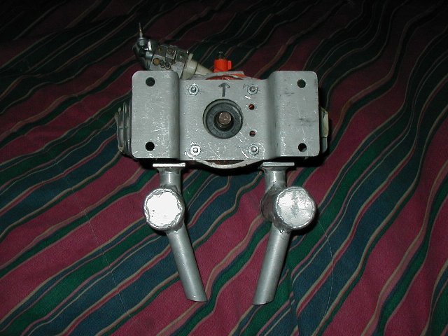

The original carb thats still on my 61 twin says HDA-7A,then theres a B5 underneath that.In the intake it says 42S.I have another carb that has an S behind the number>Do ya know what it stands for by chance.Heres a pic of my 61 so far.Mufflers are off a BME100?104?dont remember,bought them off ebay for $29.00 shipped,new,nobody bid on them.So i figured i would.Mounts from a Quadra 42?.

I have a similar carb on my Rowena. Tillotson gasket kits are freely available, you just need the number e.g. HS HDA as above. I got mine from ebay.
