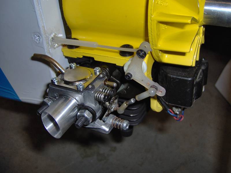

I just used a wt 263 Poulon Walbro on my 25 and it runs great! Try e-bay # 160254233856 for $4.99 plus shipping.
It was a very easy carb to modify for the Homelite and a bolt on as most of those carbs gave the same bolt pattern.
Joined: Jan 2008
Posts: 235
From: henry, IL
Here is a photo of the conversion.
For what its worth, unless you use a small prop and keep the rpms extremely high, a 13 mm carb would probably be too big for a stock 25-30 cc engine.
