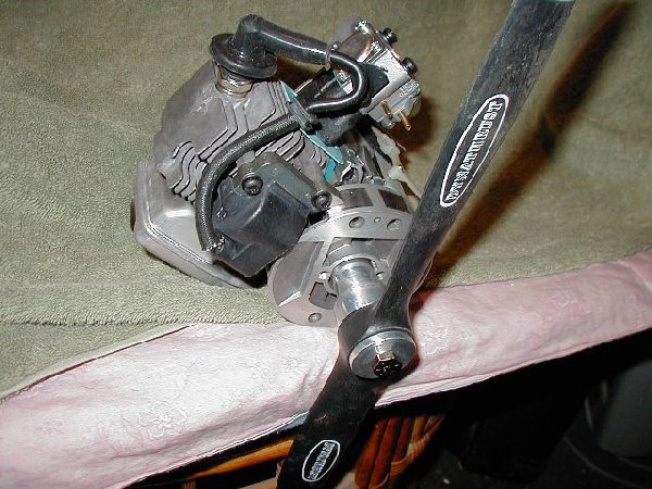

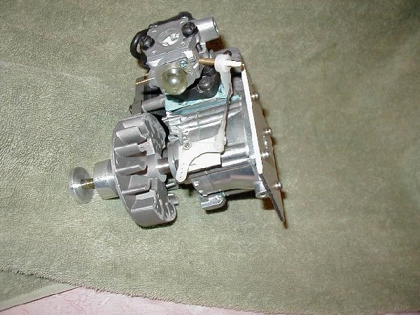

Can someone post a photo of one of the 25/26cc Torro engines. Thanks Capt,n

Heres a few pics of one of mine.I would have some better but im selling one tommorow and will be taking pics the same.This is one of the ones that where selling at 4 to a box on ebay.I bought 2 boxes.These where listed as 25cc toro or troy-built.I called the 800 number to check and they said the same.So there must be a 26cc toro that has the 2 barrel carb on it the brillelli was converting.
