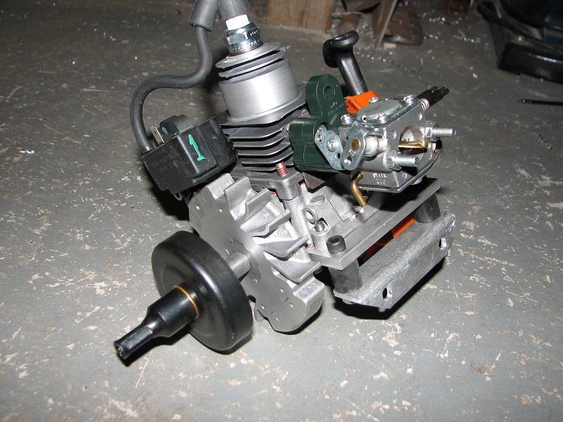

Im playing around with a 27cc stihl engine for a boat and after some searching i noticed that some of you guys on here are using that engine so i thought id post this here. Anyway I thought id try and lighten the flywheel a little, wasnt going to go too crazy, just going to cut the fins in flush to the rest of the flywheel to reduce some drag. So I went ahead and done that and when i got the fins cut down, i noticed that the casting was out by about 30 thou, meaning i had about 30 thou of fins left on one side when the other side was clean. So i decided to take another cut and face it all off the same thickness and i ended up hitting something steel. Im guessing its a part attached to the magnets to hold them in place. Once i hit this i stopped, so one side now the fins are still noticable but their almost cut flush.
I'm kinda nervous now about this thing comming apart. Alot of you plane guys run lighter flywheels right? How dangerous is it maching them down? Heres a pic of my flywheel (steel part is between the holes in the lower part of the flywheel), what do you guys think? Should I try and pick up another one?

I see what you mean now.A few of the more expensive engines dont use a full bodied cast flywheel.They use a solid steel center and then pour the cast around it.Huskys do it this way,and you found out stihls.I had an olympic that was the same way.When i turned it it looked like yours but when i screwed my hub on it covered that area up so nothing could come apart.I sent ya a pm with some info.I see youve turned down the top of the cylinder round where the fins where.Is this for the water cooling jacket to fit.I woudnt use it like that unless you could somhow tighten a flat piece of aluminum up against it that was large enough to cover at least a half inch over the whole center sectiion.

Hey guys I couldnt find a new flywheel anywhere so I made a mandrel for this one and tested it (safely) at 30,000 rpm for a few minutes in a router and it held together so I figured it would be fine.
