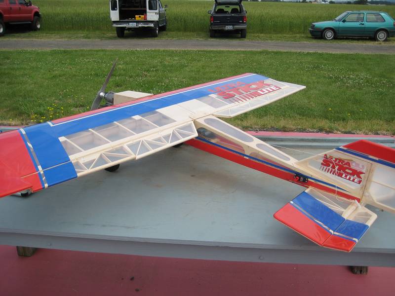

Ok I finally got this thing maidened a week ago, took it out yesterday to play some...
Pics are finally taken, didn't want to jinks anything... as you can see, Idid a couple things to the engine, it runs pretty good for what it is. Ihad a couple dead sticks due to the clunk line falling off (the hayes line expanded a little and Ineglected to wire it on... the last flight Ilanded to tune a little and it was running for me so Ijust killed it... when tuned decent it has nearly unlimited vertical, will pull out of a hover and flies good, I'm getting more used to it and am sure I'll start liking it more and more, it flies like it's on rails! been a while since I've had anything that did what Iwanted it to when Iwanted it to (was tired of the yank and wait tendencies of my trainer).
I'm more confident and fulfilled by this thing now, not it'll just be nice when the ring finishes breaking in so it'll run more consistantly.
