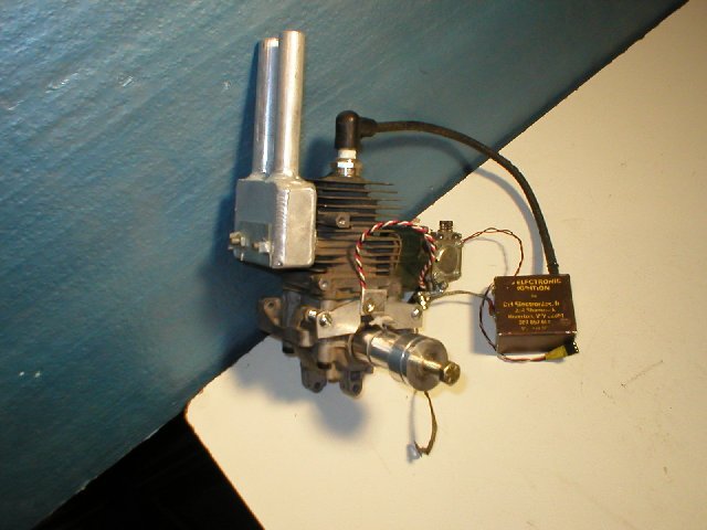

Heres a pic of my FS46 stihl.APC17x8 at 7400.Used engine i bought off a dealer.28cc[27.2cc actual].I also have the 26cc[25.9cc actual].This is suppose to be better because it comes from a pro version of weedie.Look up stihl in the search bar on the bottom right hand side of the page.Look in this forum only.Youll notice in the pic it can be rail mounted or mounted by the 3 lugs on back of engine.it comes this way stock.I did one of the weedwacker ones your talking about but i sold it as it wasnt worth it to me.Like aviator said,they will work on a high wing,or biplane as long as its light.

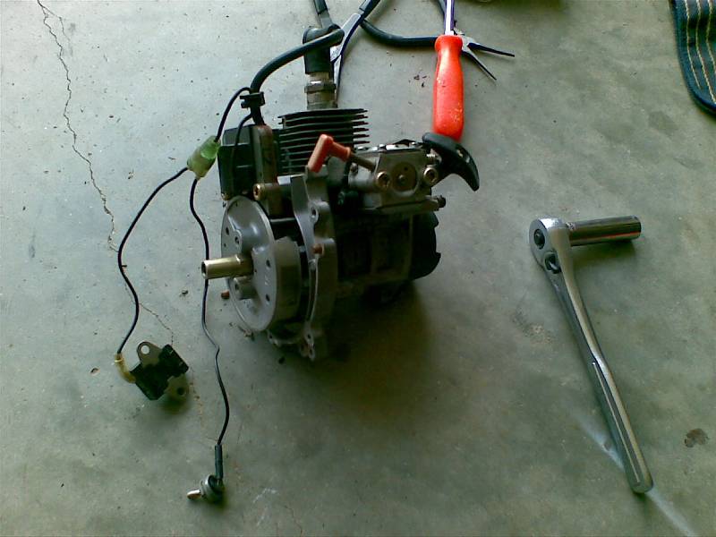

Here are a few pics of the Stihl 48 and 36
Oddly enough the bigger number is on the smaller looking engine and
the smaller number is on the bigger looking one.
The bigger one on the right as you can tell has a clutch on it.
I left it on the crankshaft to keep the flywheel from coming off.
It looks more like an RC engine than the smaller one.
When you take the clutch off, it just has a few threads on the end where the clutch was and
then there is a metal tube or sleeve that slides off the shaft and butts up against the front of the
flywheel, sorta like a spacer.
I don't see anyway to put a prop hub on this motor, but then again this would be my first conversion.

Engine on the right is a 31cc ryobi long shaft.I have a hub set already made up.I wont be using it either.One on the left not quite sure,i need a little more light on the case and the other side of engine.Some of us rebalance our flywheels some dont.Usally there not that far off anyway that ive come across.You only need about 3/8ths of an inch of threads to hold the hub on.The hubs like ya mentioned that we say are easy to make is because some of us have lathes,drill presses,ect...The long shaft ryobi for instance just uses a spacer to slip over crankshaft,about 1 inch in diameter,then you put the prop on,then a washer,then the nut.

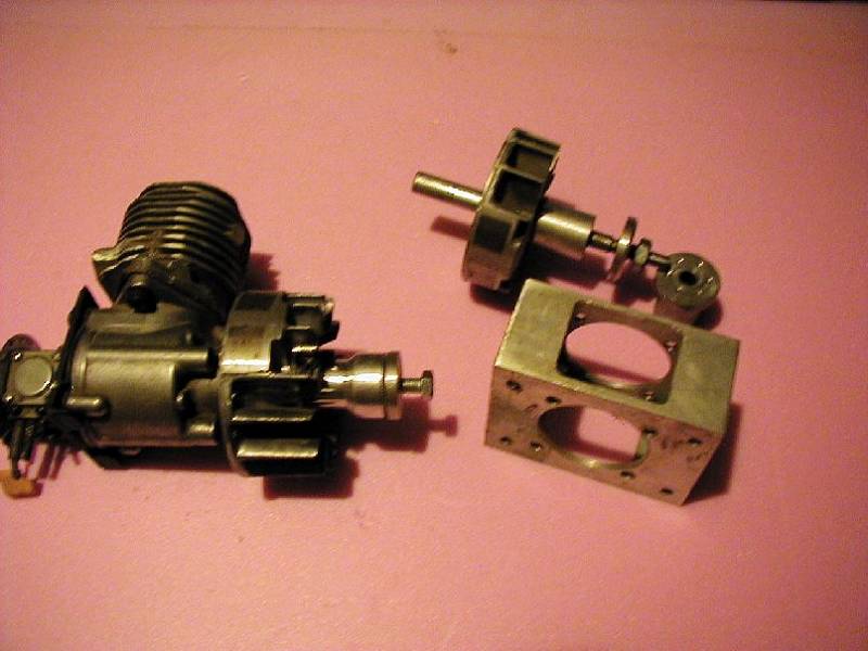

Heres a pic of the lond shaft like yours with a hub.The hub just slides on the shaft and butts up against the flywheel,then the prop sits on the hub,then the washer and then the nut holds evrything together.I also put a pic of the mount that i use.its a piece of aluminum channel and the 4 bolts on the back of engine that hold the black plastic reed case on hold the mount to back of engine.Ill send you a pm about the hub.It would be the nicer one with the bigger lip thats holding up the end of the crankshaft.The engine is one im finishing up.I turned down the fins so there round and it looks better.Im waiting on my igns to come in so i can finish it up then its going for sale.The pics arnt the best,batteries in camera are low and i put the items on a piece of pink foam.Put in ryobi 31 in the search bar at bottom right hand corner of page,search this forum only.Theres a lot of info with pics.Also go carprecission.com and check that out.Or jagengines.
