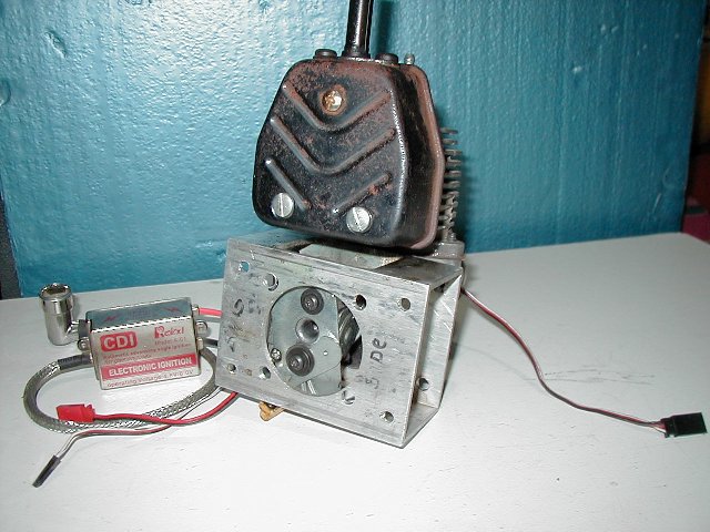

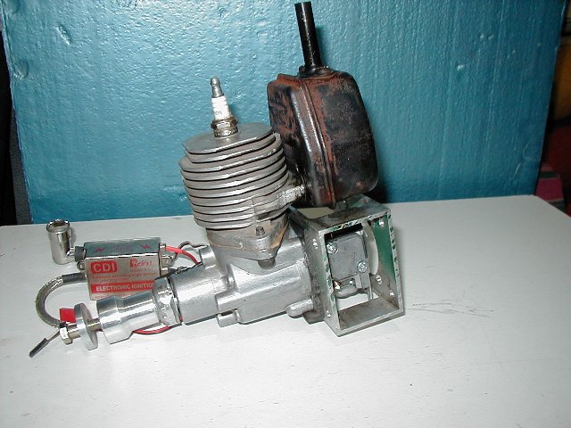

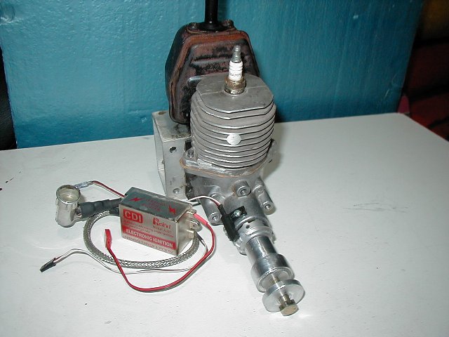

Default RE: What is this engine?
Heres a pic of how we attach rear carbed engines to a firewall.This is a ryobi 31cc.Its a piece of aluminum channell.Cutouts at the top and bottom for access.This one i put a battery cdi on it and rounded the cylinder with my lathe.
Heres the finished product. Turns an 18x8 prop 6600rpm. Not a super powerful engine, but I read the Ryobis dont like a big carb , so I used a small one on this since its made the same way. Notice I used four standoffs and two plates to get the firewall mounting figured out.
It runs well enough, and would be good for a narrow cowl (Spitfire) type aircraft. Never did find out the lawn care product it came out of.
