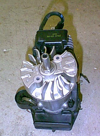

I recently found an old weedeater in the back yard that was given to my son. It was burried under a bunch of old bicycle and motorcycle stuff. Turns out it still ran.(it was there for years) It was a Homelite 31cc trimmer. Just the ticket for a first conversion attempt. I sent the flywheel to RS engines to be Machined,ordered their conversion kit, and went to work on the case. And Here are the Results:
Final Weight with Prop came in right at 4.5# , this is with muffler, V-Stack, and aluminum saftey spinner nut.
Fuel used was 91 octane, with 100-1 Amsoil Mix
RPM Results.......TopFlight 20x10 Power Point.......5400rpm
(was kind of dissapointed)
MA Classic 18x10 wide blade ......6400rpm
(getting better)
and my final test today......15x8 Power Point........ 9400 rpm
(just a test but WOW)
Next test will be with a 16x8 or 16x10 apc or MA Classic.
Final Cost with the two new big props. $110.00
Not to shabby for my first attempt. Going to put this engine on a Dynaflight FlyBaby, 84 in. wing span. Havent built it yet, but probably will over the summer.

Thanks for the advise. Still want to do some experiments with 16 and 17 in props. maybe even try some big three blade props. will also be checking static thrust with a digital fish scale eventually. going to build a test stand just for doing so.
Initial test results were done with engine mounted to the fence in the back yard. Kind of crude but it worked.

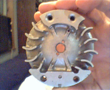

You can hacksaw/file the fins off on most engines pretty easy. The flywheel is pretty low quality aluminum. I turn mine on a lathe but if I didnt have it I would get the saw out :devious:

I thought of trying to cut the flywheel with the saw and file method, but wasnt to trusting as to weather or not it would throw off the balance. Have you or anyone else tryed this with good results? I almost did, but was a little bit too affraid of possible shrapnal flying around.

don't be afraid to cut the fins off with a hacksaw. it's more work than doing it on a lathe but the results are the same if you work carefully. after i file off the rough cuts i sand it down on a large belt sander table in my carpentry shop and constantly check the thickness at different points around the circumference.
in the pic is an echo flywheel that i sanded by hand with sandpaper glued to a marble slab before i remembered about the belt sander in my shop :stupid:
dave
dave

Hey !!!!! I thought of and idea, when you finish saw'in and file'in,
You could put, on your prop balancer to check for balance ? :stupid: Well would that work???
