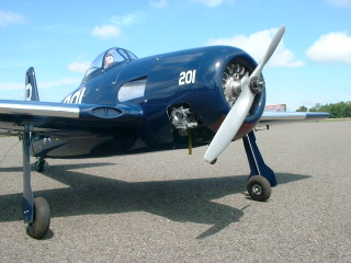

got a ryobi cs30 weedie real cheap and comenced with the conversion,got it down to 4lb.4oz. using everything stock other then adding a prop hub,mounted to the stand and i get 7300 on the top end with a 16x8 prop,my ? is will this be enough for a thundertiger bearcat,my auw will be at around 14lb.,i did have a spc 26 on her last year but the motor was poop+i had to add 24oz to the nose to balance with the spc ,with flaps deployed at 20* the plane is a real kittycat to takeoff and land,they saved my butt on quite a few ocasions with bad motor adjustments,btw i think the engine looks more like a homey then a ryobi,starts nice and runs sweet lmk what you think

thanks flathead,i ended up removing the plate from the muffler and went to a 15x10 apc and got the rpms up to 7800,mounted it in the plane and off i went,it flys the bearcat sweet!!!!!!!!! i marked the factory settings with a dremel cause the needles had no slots for adjustments and the high end needed just a kiss lean and the low end needed nothing,my auw is at around 13lbs,with 20* of flap on takeoff it was a real kittycat,does around 60-65mph,now for a conversion that got no power hopups at all,all stock other then removing nthe guts from the muff and adding a prophub and motor mount i'm very impressed to say the least!! i can still shed about 6oz. of weight if i wanted,did'nt even touch the flywheel(looks like a radial in the cowl) this motor has real potential for more power! i'll post pics of it in the plane

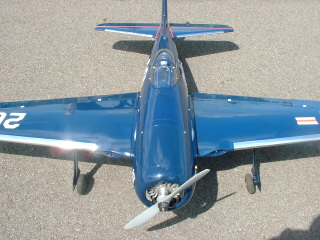

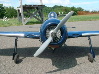

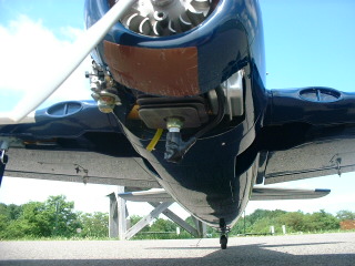

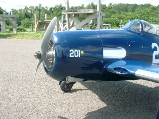

pics

Thats a Homelite....carb is on the side!!! Hey, nice looking Corsair! Capt,n
Old 07-22-2008 | 08:55 PM
My Feedback: (15)
Posts: 125
From: pgh, PA
Default RE: ryobi cs30 weedie conversion?
f8f bearcat

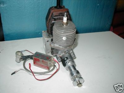

Captn,heres my ryobi,3lbs,4oz.I rounded the cylinder to make it look a little better.The mount is a piece of aluminum rectangular stock.I dont remember if i gutted the muffler or not but i dont think so.The weight includes the ign but not the battery.Magnet[hub sensor is cut out of flywheel and turned.]I only had it running on a 16x8 because its brand new and not broke in so theres no sense in posting rpms.I sold it already.

ORIGINAL: buck1856
REPLY>> Buck, that Ryobi looks nice. I have a few older ones...I should convert one all the way. I got so may going now its overwelming! Then there is my Holt 4 cylinder. The bad thing is the best of the fishing season is starting also!!!! Capt,n
