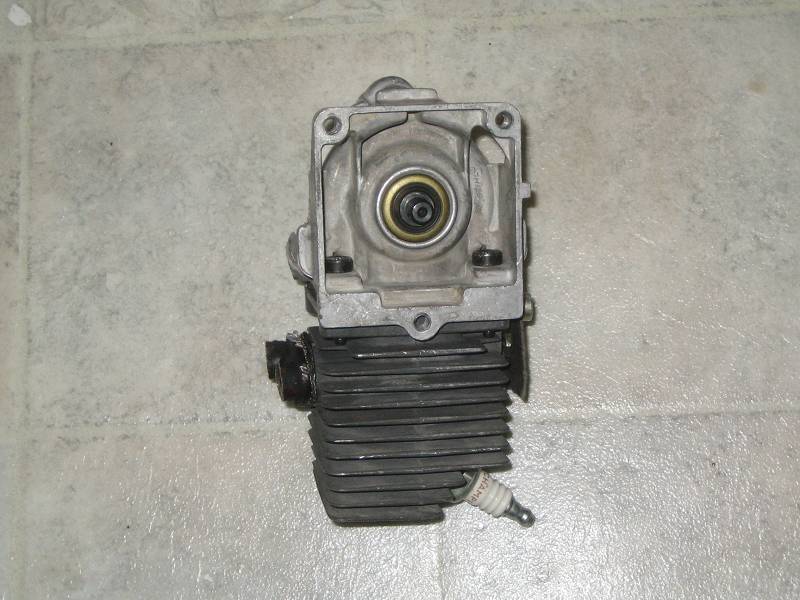

well, i got a camera with some pics. even though i have already found out what size engine this is, here they are anyways. the pics are of the engine "almost converted" in these photos, the engine only weighs about 2.5 lbs and with prop hub and muffler/mount i cant see it weighing more than 3 lbs. not bad for a conversion![img][/img]

Yup,thats the 25.Mines exactly like it but in more pieces as i need rings.I sent ya a PM.

from what i was told, this one was only used for about one season or so. i would like to get a frank bowman ring, cause the end gap isnt as tight as i would like it, but i will run it as is and see what kind of power i get. if its all i need, the ring will wait.
