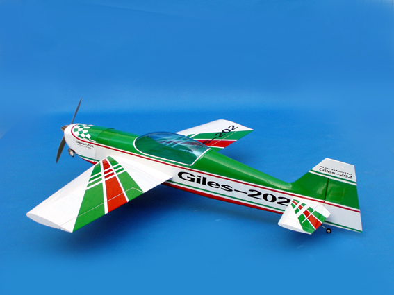

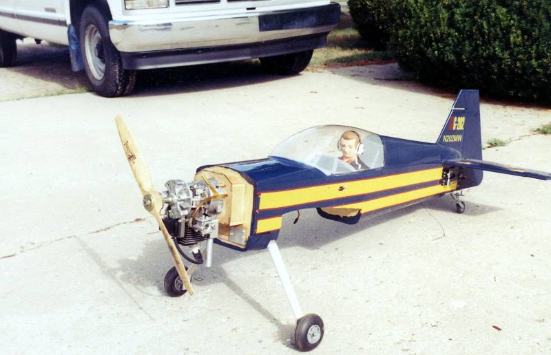

buck1856: Was the Giles one of these? Capt,n

No it was the red,white,and yellow one that tower was selling about 2 yrs ago from Great Planes.
