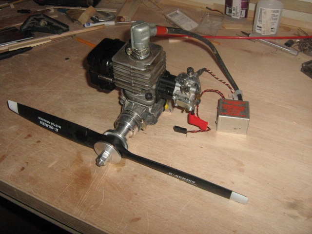

I think I have a 21cc featherlite here. I have a good carb for it. I have a CH ignition for it. Where can I get a prop hub and a backplate mount? I did a couple searches and came up with old posts from 2003 and 2004. Conversions have come a long way since then. Somebody has got to be running one of these.
I'm planning to mount it in a Midwest Citabria. I'm hoping the engine will turn a 14-6 around 7000-8000RPM. I haven't done and machine work to it. Is there a larger carb that works good? I have the WT615 with choke plate and twin needles. It's got an 18/64 venturi.
Any comments on these engines?

I've been working with one of these and you should be able to hit the rpm your looking at. I've got a 14-8 on mine (its what I had on hand) and get around 7300 with stock ignition. Muffler has baffle removed with a 2'' x .5 diameter discharge extension welded on. I'm still fighting either an air leak or my carb is too big. To get high mixture close my needle is about to fall out running with about 1/4 choke. Adapter was made from stock square drive drilled and tapped with a large diameter washer welded on for prop.
I don't think mine is going work out for my project though. Was going to put it on a bridi old timer but I don't think its going to have the umph needed.

I ordered a "timing kit" from Terry @ CH today. He's a really fun guy to talk too. [sm=thumbs_up.gif]
I am pretty certain he is sending a hub with magnet and a bolt/washer for my prop. I forgot the backplate mount and had to call him back immediately. He had both in stock. I totally scored today. Very excited to get the parts and fire this bugger up. I want to make sure it runs okay before I drill my firewall.

My 21cc had the long shaft so a prop hub consisted of only a spacer, as for performance i was getting 6800 on a 16x8 TF wood and 7200 on an APC 17x6, i was running on the GAS/GLOW setup and the total weight of the engine was just under 32oz.

I tried working with Carr Precision, since they advertise the Featherlite conversion. It's extremely difficult to get anyone on the phone. I tried no less than 2 different email addy's on the site and both bounced back as undeliverable. Finally got somebody on the phone a week later (after about 20 attempts at calling during regular hours) and he says he doesn't have any parts in stock. It's an older engine and not much power. Not worth converting.
Screw it!! [>:]
Called CH and Terry answered the phone on my 1st attempt. Had the parts in stock. Sent them out that same week. I had the parts on Friday. $60.
Thanks Terry!!!
I'm planning to run the engine in stock form first. It if turns a 14-6 or a 15-6 at any decent RPM, I'll just fly it. If it hasn't got enough power, I will run a couple different props to get some solid baseline numbers and then I'll tear it apart and port it. I've been reading threads on porting this engine.
I don't have a larger carb. I do have 24/64 and 30/64 carbs, but those are WAAAY too big. Stock carb is 18/64 and W8YE said I could probably use a 20/64. I might be able to dig one up somewhere, but for now it retains the stock carb venturi. I did swap out the factory carb with one that has a choke lever. Same size venturi, just a choke lever to make starting easier.
I found some thinner gasket material for the backplate. It's 1/2 as thick as the stock gasket and still leaves 1/16" between the crank pin and the backplate. That alone would probably stuff the case enough to show an improvement. I haven't bought it yet. I wanted to give the engine an honest chance at putting out good numbers before I started modifying it.

My compression feels low. Might need a ring. The piston and cylinder look good. There's some blow by on the piston and a little carbon on top. I was able to rub a lot of the carbon off the top with a paper towel. Ring is free-floating. It could be just the engine is dry or the ring may be shot. I'll have to start it to know for sure.

When all else fails let logic do some troubleshooting. My carb was bought "new" from bayworld and certainly appears new. I didn't want to tear it apart but, voila', crap in jet = only run with choke on.
Now it is SWEET!. 7800 with MA 14-8, idle a little high but not bad..
