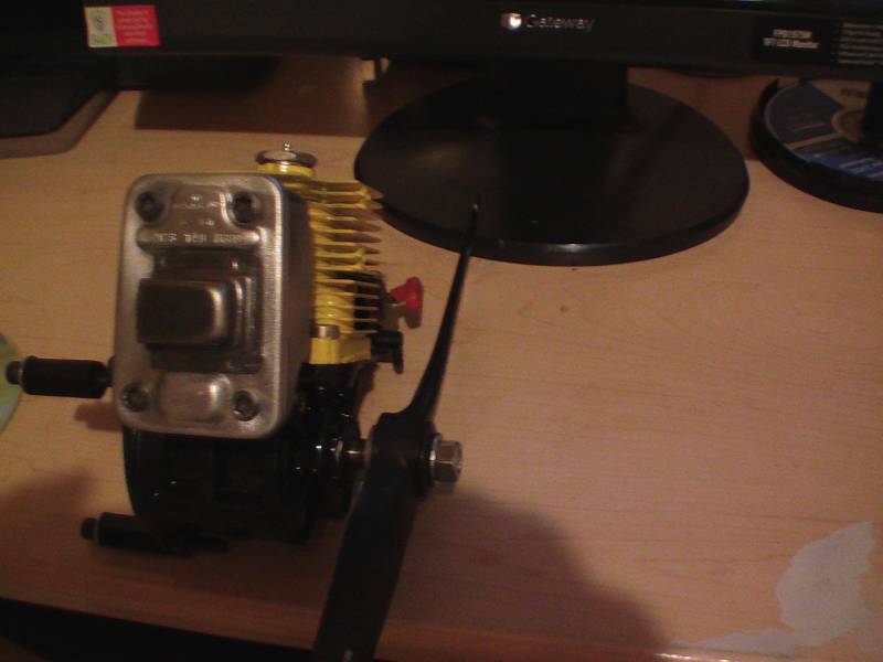

Old 01-29-2009 | 09:44 PM
  #57
My Feedback: (10)
Posts: 132
From: Harrisburg, SD
Default RE: "Don't forget Stihl"
ORIGINAL: buck1856
Ill have to see if i have one made up or have to make one.Do you plan on using the center out of the flywheel or do you need one made up for that.
Or are you going over the whole shaft?
This is where i do not know for sure what to do. what is the best way to go?
ID:	1122779   Click image for larger version

I recieved your email and responded.Are you sure there left hand threads?
Old 01-30-2009 | 12:13 AM
  #59
buck1856's Avatar
My Feedback: (49)
Posts: 1,158
From: Superior, AZ
I do have one that fits over the crankshaft,it right hand threads and or 8x1.25.Is that what you have.There the same as an echo.Ill send a pic in a PM.
Old 01-30-2009 | 07:55 PM
  #60
My Feedback: (10)
Posts: 132
crank is 5/16 diameter, 20 threads per inch, left hand threads, no taper

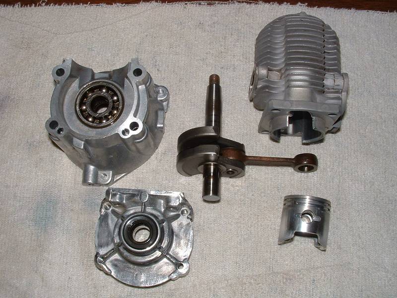

Old 03-18-2009 | 09:52 AM
  #61
Joined: Apr 2007
Posts: 1,111
From: Lancaster, WI
I finally got the FS80 put together and on the test stand. I put a set of Bowman rings in and cleaned it up. Mixed up a batch of gas oil about 40 to 1 and put a 16x6 MAS prop. I got 8100 RPM on it which I thought was ok but it still lacks compression. Maybe the rings will take awhile to seat with the Chrome cylinder??? I think I'll try a bigger 17x6 or 16x8 to 10 and see if it pulls the same-could be it just won't rev any more than that based on the porting. Lite engine with OK power though.
ID:	1160381   Click image for larger version
Old 03-18-2009 | 10:37 AM
  #62
RTK's Avatar
RTK
Joined: Apr 2003
Posts: 4,890
From: Left Coast , CA
Maybe your cylinder is not round (concentric), any scoring???
Old 03-18-2009 | 10:44 AM
  #63
Joined: Apr 2007
Posts: 1,111
From: Lancaster, WI
Nope! Perfect shape, I think it needs more than 10oz of fuel run through it?
Old 03-18-2009 | 11:01 AM
  #64
RTK's Avatar
RTK
Joined: Apr 2003
Posts: 4,890
Hmm, what type of coating is in the cylinder?? or is it sleeved. I'm not familiar with this engine. You might have to take a scotch pad and mildly scrub the cylinder, depending on the coating. Once the rings color (usually black) is gone, they are seated.
Ten oz's of fuel is not much, but usually, especially with two rings, you have decent compression right off of the bat.
Old 03-18-2009 | 11:24 AM
  #65
Joined: Apr 2007
Posts: 1,111
From: Lancaster, WI
I agree with two rings it should be good quickly-scotch brite pad wouldn't do a thing, 600 wet paper will hardly touch it. It may be designed with the this compression.
Old 03-18-2009 | 07:56 PM
  #66
j_t01's Avatar
Joined: Nov 2006
Posts: 146
From: seacoast, NH
Dont scuff,sand or scotch brite a chrome cylinder. The chrome is a hard surface needed to prevent the rings from wearing out the cylinder. The rings will wear to the chrome not the other way around.
Jim

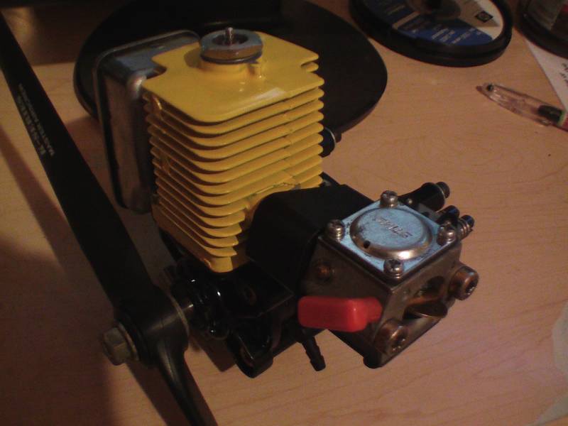

Old 09-28-2009 | 02:14 PM
  #68
FlyingGreg's Avatar
Posts: 639
From: West Chester, OH
Default RE:
Guyscan you help a novice out with a conversion question. It's a Stihl 25CC that I bought from a guy that had already had the conversion mostly done. The only think I had to do was complete the spacer between the carb and the engine. I did as was told and dremmeled out a little channel to allow air or fuel to pass. The engine will run fine for one flight then it bogs down like it's not getting fuel on subesquent flights. It has a walbro carb but twisting the needles has very little effect. I cleaned out the filter screen but no better. Last weekend, I made a new gasket but have not run it yet. My question is, what is that spacer for between the carb and engine? I need to get another prop also. The engine is in my 1/4 scale cub. What is a good prop?
Greg
Old 09-28-2009 | 02:27 PM
  #69
Joined: Apr 2007
Posts: 1,111
From: Lancaster, WI
Default RE: RE:
Greg,
The spacer is a heat sheild for the carb-they don't like heat. Also make sure the small hole in the spcer line up with the carb. This is a pulse hole that creates the pressure to run the diaphram in the carb and pull fuel from your tank. This must be correct to get it to tune properly. Sorry if i stepped in.
16x8 prop should be a good start
Old 09-28-2009 | 02:48 PM
  #70
FlyingGreg's Avatar
Posts: 639
Default RE:
Thanks Frenchie. I can run a pin through the hole into the engine but I don't think it lines up perfectly. I may need to enlage it just a tad. Will that have negative effect? I made the gasket out of a manila file. What gasket material do you recommend?
Greg
Old 09-28-2009 | 03:06 PM
  #71
Joined: Apr 2007
Posts: 1,111
From: Lancaster, WI
Default RE: RE:
The material used i believe is called G-3??or 7-Garolite. It is expensive and hard to work with but why don't you just get the stock manifold or have one made. Maybe some other will chime in.
The pulse hole should be a 1/16th to 1/8th in diameter. Make sure that it is free flowing and sealed off from the main carb and outside air.
