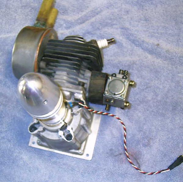

I have a converted Echo 38 cc from a SR 3800 brush cutter. It is running on CH syncrospark and turns a 20 X 10 MA semitar @ 7400 rpm. Don't have a plane for it yet, but it is a strong engine.

Whats the total up and running weight of your echo?

As you see it in the photo attached it is 3# and 14 oz, not including the ignition box and battery.
In my previous post I said that it would turn 7400 on a MA wood semitar 20 X 10. I transcribed a couple of numbers. The 7400 rpm was on a MA wood semitar 20 X 8. The 20 X 10 was 6900 rpn.
