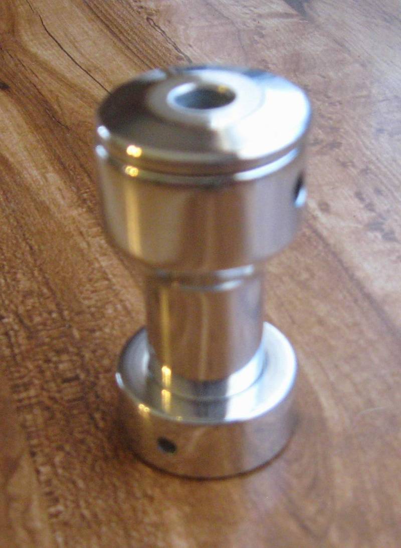

Old 09-27-2008 | 08:19 PM
av8tor1977's Avatar
Joined: May 2003
Posts: 7,245
Received 6 Likes on 5 Posts
From: Tucson, AZ
Default RE: My First Conversion!!
Here is a prop hub I made for one of my brother's Echo engines. If/when I run electronic ignition, I always make a prop hub with an adjustable collar like this one. It makes it so easy to adjust the timing....
Sorry the pic is a little fuzzy. My camera isn't good at close ups..... or maybe it's me that's not so good at taking close ups!!
AV8TOR

av8tor: This adapter looks like Stainless Steel...seems to heavy. Can you make one for me, but aluminum? Thanks

Hi,
It's not stainless steel, it's polished aluminum. Sorry, but I just don't have time to make things for other people at the moment. I had to "steal" the time to make this one for my brother!
AV8TOR
