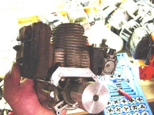

Hi everyone,
I'm working on a little 16cc Echo/Kioritz engine conversion for my first gas model project. Just thought I would let everyone know that these little guys have no taper on the crank where the mag goes on, and this will make it a lot easier to come up with a homemade prop adapter assuming you convert to battery ignition. Also, this site has an interesting kit to build an ignition:

Thanks for the pic. What were you intending to use yours on?

almost any coil will work with cdi but the lower the inductance the better. kettering ign needs a large (lots of winds) primary winding and heavy iron core in order to build up and store the charge that it dumps through the secondary. all this is just a hinderance to cdi as it only uses the coil as a step-up transformer.
in the pic is a cut up echo cdi coil. in the middle is a tiny ferrite core and the bottom layer in the stacked windings is the primary which is only 27 turns. this thing only weighs only 12g! it wont do squat with a kettering ign but is ideal for cdi.
i think the echo and zenoah coils are the same and ch uses the oem coil on their zenoah conversions so i bet your coil is compatible with the ch circuit.
dave

I've decided to stick with gas with this little guy. I've ordered some APC props from Tower, along with a NiMh battery pack for the electronic ignition. Monday I'll be ordering the ignition from CH. I'll keep you all updated as this project unfolds. One note; I was able to bolt a prop directly to the engine without an adapter. (This crank has no taper.) The prop passes by the engine cylinder with about 3/4" clearance. Think this is too close for prop efficiency???? This setup will not be cowled, so except for the short time that the prop passes the engine cylinder it will be in free and clear air for it's full length. It would be great not to have to add the weight of a prop adapter/extension.

av8tor, the tip of the prop does most of the work so don't worry about the clearance thing. also these engines only have a single bearing support on the prop side so its best to keep the hub as short as possible so you won't get run-out problems. you do need some kind of drive washer though, just letting the prop seat on the step of the shaft sounds bad to me. do you have room for a washer of some kind?

Yes, I have washers on there. I'm using the original washer that was behind the mag, then two more 5/16 washers, the prop, then a washer and the nut. Works perfect! Less weight and expense... it's all good. (I'm going to make a collar for the crankshaft on the other side of the engine for the magnet for the ignition. That's cool too as it will be inside the little "bell housing" area and protected behind the engine.)
