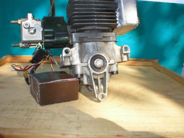

28cc stihl,FS-46 weedy.Heres a pic of mine.This is how it comes from the unit.3 point mount in back,rail on sides with holes already drilled.This is stock configuration.Im sending you a pm.

Av8tor,i took the 17x8 APC off of my OS 1.60 and put it on the stihl in the pic.I was getting 7200 RPMS.Im at 3000 MSL.The whole engine as in the pic only weighs 3-1/4 lbs.This engine was used when i bought it.I did nothing but what you see in the pic.Carb is a WA200 with a 28/64ths venturi.Cut out center of flywheel with hole saw then trued up in lathe and made hub.Ken made the muffler.CHignition is older style with no syncro i believe.It is 27.2 actual ccs.
The 30cc echo is either a CS-3000,CS300,or maybe the CS306.Somone would have to look up the individual parts schematics to determine wich one would come out of the case and not have to cut out of the case.
