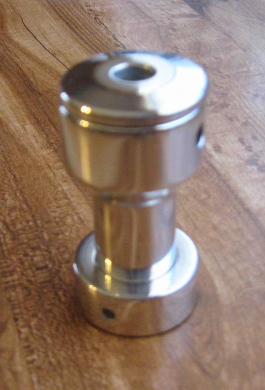

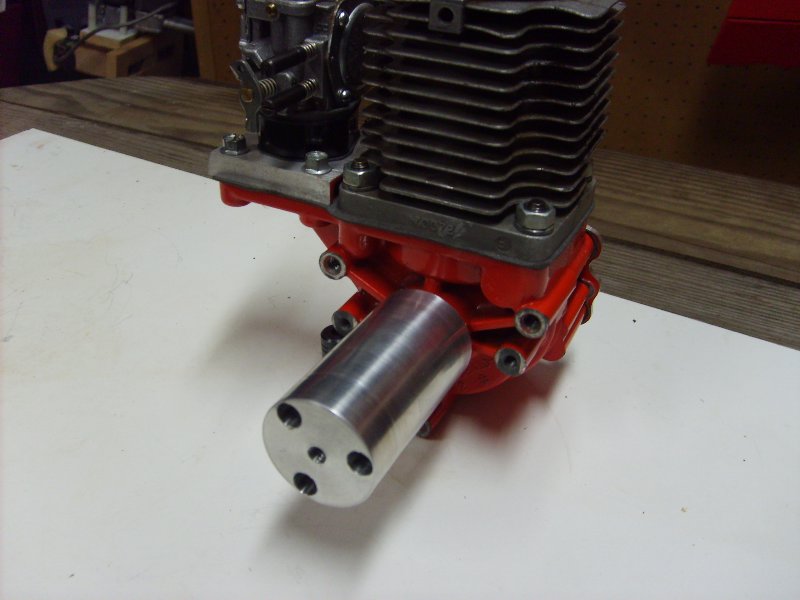

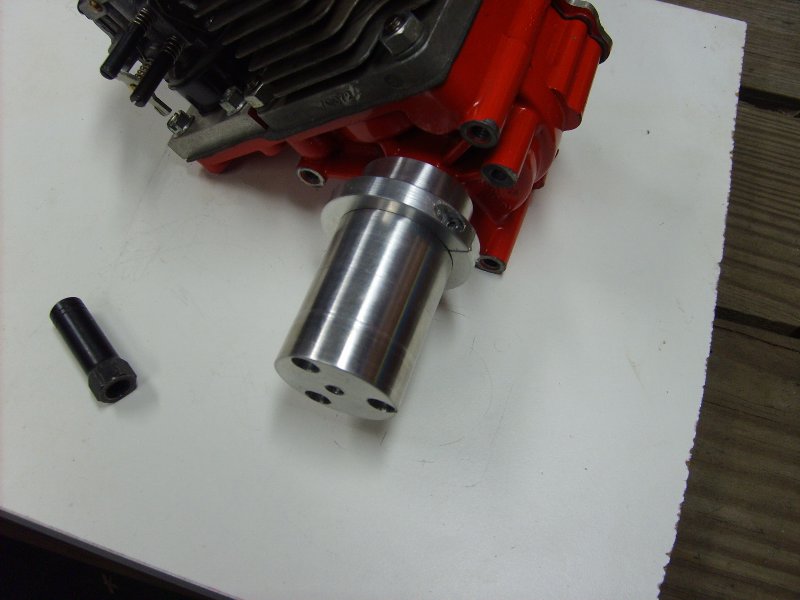

I got my new lathe up and running and have been playing around with hubs and stand-offs lately. I just got done with my new hub for my short shaft 54cc homelite. It was a fairly complex hub because I extended it back past the tapered key section so that it would come flush with the crankcase for a nice clean look,plus the case had a little ring around it that the hub overlaps(wish I would have taken a picture before I bolted on the hub. So,a good bit of the back section of the hub is hollow. I also chose to use 3 screws to which will be hidden after the prop is mounted to join the halves together instead of machining a much larger diameter hub which would have let me join the halves with screws on the outside after tapering it. I also cut out a split ring that will house my ignition magnet that will be adjustable. I have to pound some grooves onto the face yet so the prop doesnt slip,but I'll do that later. I cant wait to get this engine running. Whatta ya think?

Nice job,nice.I have the same style of ring i found on the gooseneck of a bicycle.Has the same style of bolt setup.Did you make that as well?

Nice work. I would suggest that you make the prop fastener a stud, rather than a bolt and loctite it in. Good luck, red

Good call coralcape. That's how I do all mine; with a stud for the prop.

Yes,I made the ring too. I think next time I'll try a different setup like maybe a simple set screw setup or something instead of the clamping style. Its a pain to make the recesses in the ring to countersink the screws and stuff. I might even incorperate the ring into the hub itself that will clamp in in place when you bolt the hub together(hard to explain,lol). And yes,I might do a stud style later I guess,but I've never had any issues with the bolt style on my other big gas engines as long as you leave enough room for threads. .

I just make my collars full circle with set screws instead of "clamp style". Just as effective; much easier...

Here's a pic of one of my prop hubs with a collar like I mentioned. Set screw on one side; magnet on the other. The compression collars like you made Jester also work well and look nice however.
Sorry the pic is a bit blurry, and the hub doesn't have a stud installed yet.

My warning about using a stud comes from experience. I find that the threads in a aluminum adapter tend to wallow out over time, this doesn't happen with a steel stud. I feel that the clamp type of adapter is the best. I usually cut the whole thing as a unit and drill the clamp holes before I separate it. I find this type of adapter won't come loose on the crank, as a screw on might. As to run out, I use a four jaw chuck and set this up with no run out before I do any cutting. Good luck, red

OK Capt'n. First pic is a 45cc homelite on a N.W. hobbies corsair, notice the sensor mag is on the main hub. I find once the prop adpt'r is tightened on the taper it will not move, so no need for separate ring. Second pic is 61cc husquarvna on a 30% QueQui yak54. The sensor ring is on the rear hub. I couldn't help putting on pics of the corsair. It's 85" ws and is covered in alum duct tape. All seams done with simulated rivets. Looks great, but had to add nose checkerboard to see it in the air. Here in sunny S.Fl. (75 today) it's hard to see light colored planes.
