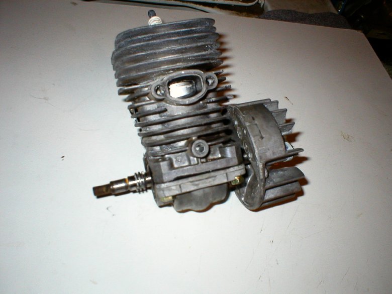

Hello Mark,didnt i sell ya some of those bud bottles?Anyway,are you looking for somthing like this.Its the Poulan 42cc.This was one of scotts first engines he started converting.[not this one],the style.
The nice thing about this one is the carb is bolted to the block[cyl] and doesnt use the rubber boot like the 46 that you need a special adaptor to make it fit.
Anyway,this has been sitting for a while,the compression is still good,might need a new ring.I would run it first though. but im doing an echo 45cc out of a blower.So i dont need this one.Send me a PM if interested with your addy.
Ill ship to you,no problem.
Youll notice the side pic of the piston its shiny and theres no scoring in cylinder.

Old 11-26-2008 | 11:37 AM
Joined: Apr 2005
Posts: 2,428
From: Calgary, AB, CANADA
Default RE: Where To Find Poulan 46cc Engine?
Hey Buck,
Sorry for the slow reply, I have been working too much... Yes you did send me some bottles. They are patiently waiting for me to get to that point on my list of things to do.
Reportedly, the 46 is significantly lighter than the 42 and should make more power with the extra displacement. Thanks for the offer, but I think I will hold out for the 46 or an Echo 45 or 50 if I can find one. If I get desparate I will PM you about the 42.
Mark

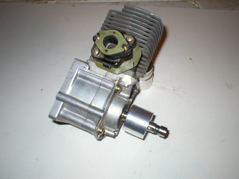

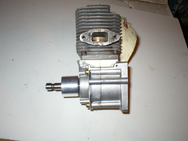

Well,how about something that looks like this Echo 45cc from a blower?

What do ya think about the echo 45 im doing in post 4.
Old 12-09-2008 | 11:57 PM
av8tor1977's Avatar
Joined: May 2003
Posts: 7,245
Received 6 Likes on 5 Posts
From: Tucson, AZ
That Echo makes a great engine. Better than the Poulan in my opinion.
Nice job trimming that case up there Buck!

Thanks av8tor.The only thing is it has the straight crank shaft.I was thinking about doing it like the ryobi 31 and just use a set screw on the side where the keyway would go,and then put the magnet apposite to kind of balance it out a little,then just use the nut to hold it all on..But being anything that close to the center of the crank and light shouldnt cause any imblance that is noticible.
Or,would it be better to rethread the crank and then use a nut to hold down the hub in the center like a G62,and use 2 bolts to hold the hub on.
Also,how would somone make the square keyway in the hub.What tool do ya use.This engine used the bar stock keyway,1/4x2 inches.[or a little less maybe].
Old 12-10-2008 | 07:58 PM
av8tor1977's Avatar
Joined: May 2003
Posts: 7,245
From: Tucson, AZ
Either way should work fine.
Another method I have been thinking about is making a collet type setup like is used on glow engines. You know; it uses a split collet on the crank, and then a prop driver hub with a taper that fits the collet.
AV8TOR
