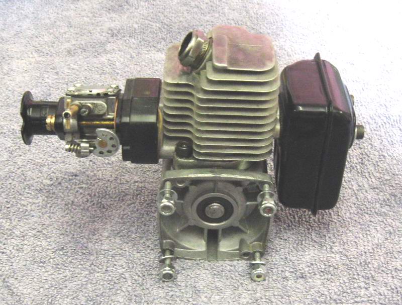

I just got through converting and souping up an Echo 21.2cc engine for my brother. We all look for the better 23.6cc engine, but this 21cc turned out pretty well.
Specs:
Port timings changed to:
Exhaust 150 degrees
Intake 143 degrees
Transfers 100 degrees
Free flowing muffler
9.5 mm carb "massaged" to 9.7 mm
Carb adapter opened up to match carb outlet
Deck clearance set to .020"
Frank Bowman top ring at .001" gap
Stock second ring
Running on Gas/Glow, after only one tank of fuel it turns an APC 14 x 8 at 9600 rpms!
I don't have other props on hand at the moment, but it should turn a 16 x 8 at over 8000 rpms. Not bad for a little 21cc, $10.00 engine...

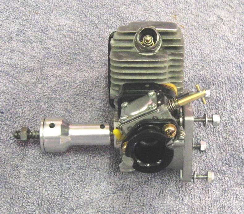

Here's some pics of the little guy. Fun project. It weighs 2 lbs. 8 oz. as shown, ready to fly.

how were you attaching the prop drive?
Old 10-18-2010 | 11:07 AM
av8tor1977's Avatar
Joined: May 2003
Posts: 7,245
Received 6 Likes on 5 Posts
From: Tucson, AZ
Default RE: ECHO Don't shun the 21
The prop hub screws on, and has a set screw that goes against the crankshaft for extra security.

Oh the prop adapter doesn't move once installed. I use Loctite on the threads, and then with the set screw besides, it doesn't budge. Often times when I take them off I have to heat them to get them to come loose.
This particular engine was set up to run Gas/Glow, and it doesn't use a Hall sensor. When I use electronic ignition, I make up an adjustable collar that goes around the small diameter of the prop adapter. The magnet goes in the collar, and the timing adjustment is made there. Works fine, and has done so for many years.

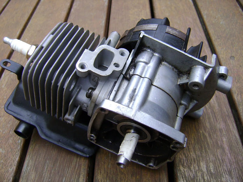

I just found this thread. I have an Echo 21 which had some sort of custom ignition system added. This has a throttle adjustable advance system, but the wires to the hall sensor cracked. I believe C&H (out of business) sold an ignition system with no auto-advance. The only systems I can now find are auto advance such as RCexel. I did test the engine on gas-glow and I may continue to do that. But I am wondering if there are any non-advance ignitions available these days, so I can use the original thottle advance. I may also remove the throttle advance and use an RCexel.
Anyway it's a cute small engine which will find a home on a plane sometime.[X(]
