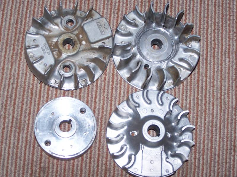

AV8TOR, I liked you idea too, but I just went and weighed 4 flywheels I had off engines. The lightest was a small dia one off a Zenoah that weighed 208 Grams. It felt heavy for its size...I think bcause the material is not much aluminum but heavy metal magnets. The next was a Torro (IKEDA-uko841) 3 3/8 dia and weighed 237 grams...not that much more. Next was a Phelon at 303 grams (metal pins removed) and last was another Pheoln at 273 grams (4039 with pins removed) with 3 3/8 dia. I think because of hi cost of some small dia flywheels & the little weight saving that we need to improve a mag only system that is not a "blower" or a "heavy flywheel". Capt,n[X(] EDIT Added photo

Here is something similar to your idea Captain, and maybe a start? It doesn't create high tension voltage, but could run a battery powered ignition system without a battery. One would possibly have to buffer the circuit and use a voltage regulator if you wanted to run without a battery I imagine...
http://www.sullivanproducts.com/GenesysMainFrame.htm
AV8TOR

AV8TOR, I looked around on the web-site and it looks like some of the technology is right there. The rotor and magnet system could be modified. I would like see a mag made using just the same components they use now ,but made for ignition only. No extra flywheel weight or cooling fins and smaller air gap type coils used. We got a way to go, but with several people putting good ideas together it can happen. Capt,n
