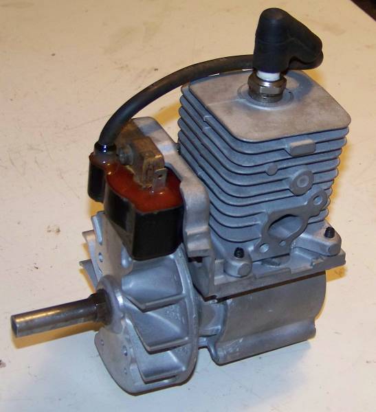

There is a guy selling these WT-324, 11mm carbs with plastic velocity stack. He says it will work on my Homelite 25cc weedeater engine.
Will it? And if so what mods will I have to do to make it work? Or is it plug and play?
John

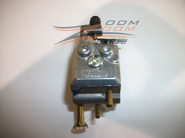

I want to use the wt 324 on my moki glow to gas but i am confused the fuel lines is just under the plate with walbro on it the other one activates the diafram on the needle side. Must you drill and tap your own hole on the plate with walbro written on it , what must you do with the other pipe

The smaller one must be plugged
The other is the fuel inlet
The pulse signal hole is in the end that bolts to the engine
If you run a external pulse line, you must drill and tap the Walbro cover at one of the bosses and mount a nipple

thanks , I worked it out from the differant pst but wanted to make sure . Thanks again for quick responce.
