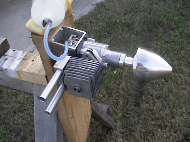

Av8tor,
The smaller poulan saws don't have the mag bolted to the cylinder. However, CH ignition kit bolts right to it for about $150.
Makes them MUCH lighter without flywheel.
However...the Homelite 33 DOES....Look for the RS engines Brute 33... VERY easy conversion...
Your other option is the Ryobi 31cc.
Those are the two easiest conversions around the 30 cc range.

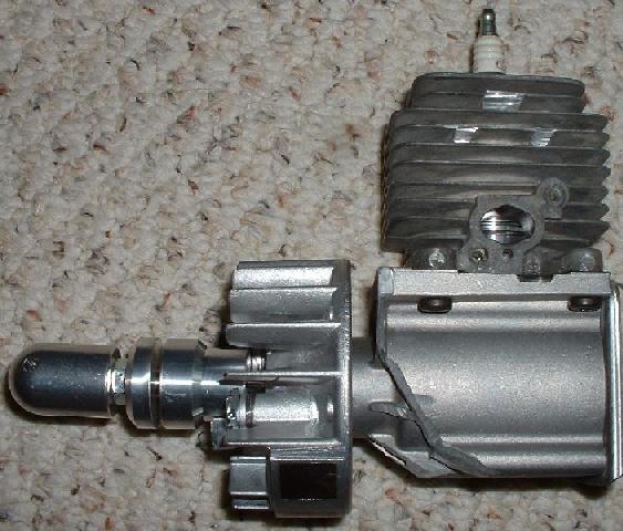

Craig, I am going off of my Ryobi 31cc, which I converted to glow. The setup as shown in the picture (minus the spinner) is just under 3lbs, according to my 5lbs postal scale. The CH Ignition module I have for it weighs less than 4 Oz. If I use a light weight battery pack, I can fairly easily stay under 3-1/2 lbs.
The engine in the picture also has a lot of the unnecessary bosses and appendages ground off. I could probably take off another 1-2 Oz. if I really wanted to. Also, the B&B muffler stingers most likely can be shortened. Plus it really only needs one stinger anyway. It's substantially quiter with one pipe blocked off and I only saw 100-200 rpm drop.

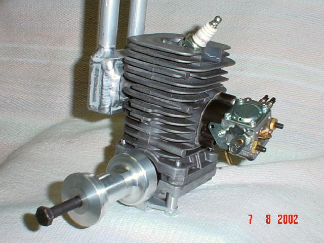

The Homie 30cc needs a lot more pruning, as I mentioned above. Here the work I have done on mine so far. The bare short block with only the spark plug weighs in at 2 lbs 3.7 Oz. so far. That is without the flywheel and prop nut in the picture. I don't like to run my conversions on flywheel. It's on there now as a crank turning knob.
I'm sure I can get the short block to under 2 lbs, which puts me back even with the Ryobi 31cc.
The potential is there, if maybe requiring a few more clams and a couple jars of elbow grease.

I'm currently running my RCS on a 13 lb H9 Edge with a Bambula 16x8. It pulls it around just fine....I have enough vertical to not even worry..pretty much unlimited vertical if I enter the up-line with some sort of airspeed. Crawls out of hover....I'm more impressed with the motor than the plane that's for sure...It's very "scale-like" in power to the full size Edge. Which by any means is not too shabby!!
I run a smaller 8 oz tank and have yet to run out of fuel even after 15 min flight.
To avoid the extra weight of an engine mount, maybe the FPE 1.3 is a decent choice....I haven't heard much about this motor though. There's also the newer Zenoah G-26...but I think it's a little heavier.
