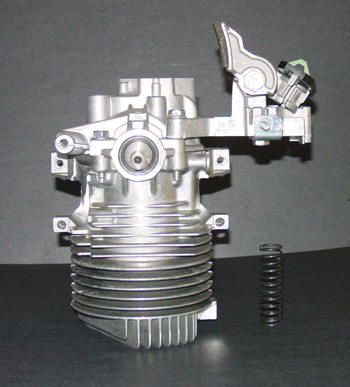

Old 02-29-2004, 06:05 PM
mac49
Join Date: Jun 2002
Location: BREMERTON, WA
Posts: 66
Default RE: Lawnboy Engines?
Thought I'd add my nickels worth. Pictures, if they uploaded, are of an F-series short block by lawn-boy. I just received it in the mail as a long term project. It's quite different from the M-series that I saw pictures of here earlier. I'm interested in keeping the weight down so I think I'll be converting this to E85 glow fuel to see how it runs. I've been following another thread that has really introduced some interesting concepts that are worth trying. This particular engine has the carb mounted below the crankshaft. It is listed with a carb having a .5" venturi but I'd think it should support something larger. I've got a WJ-10A that looks like it can be attached using an adapter. The carb flang is square and has a reed on the inside and there is a pressure tap located in the flange. There are cast-in lugs that could be used for mounting. I believe the long shaft PTO side needs to be cut off and a tapered hub cut for the prop. I haven't confirmed the displacement yet but it looks to be up around 120 to 140 cc's. It is pretty short stroked and appears to be on ball bearings from a diagram I downloaded from lawn-boy. There is a bolted on assembly that is part of the blade brake; it comes right off. I haven't weighted it yet but my guess is that it weights as much as two of my ST 4500 engines. I've got a really large bi-plane in mind as its future home. I don't think I'll need to add any additional weight in the nose for my overweight tail. Anyone have any thoughts as to a starting point on the prop?
ID:	106344   Click image for larger version
ID:	106345   Click image for larger version
ID:	106346   Click image for larger version
Old 03-02-2004, 07:57 AM
triangle
Join Date: Sep 2002
Location: Lake Worth, FL
Posts: 204
where did you get the engine???
