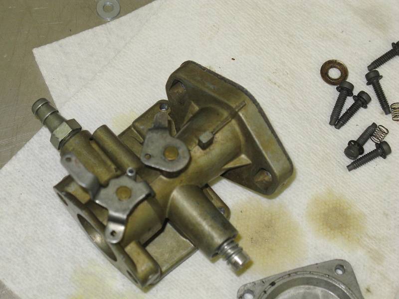

I have an older Snow Chief snow thrower with a B&S 3.5 hp 2 cycle engine. Need a carb diaphram for it. But I can't find any #'s on it any where. Carb doesn't have any info either except for a 1 on it. Will get pictures.

Here are a couple pictures.

On the cover you removed that has the pull starter there are the groups of numbers. Mod, type and code. Bring those numbers or the whole cover to your nearest small engine shop and they should be able to get the parts for you.

I have looked and with the light at different angles. Can't see any thing. Unless the paint is so thick it is covered up.

If I remember correctly, they used a Tillotson carb. Tillotson carbs were very popular years ago, before I ever heard of Walbro's.
