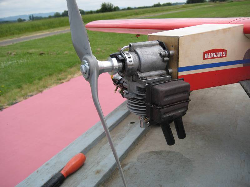

THIS is your best bet ignition wise, it has everything you would need other than the prop hub and a battery.
I used pretty much the same thing on my Mac 32cc engine and it runs good, I would suggest making a hub with a taper in the back and a ring with setscrew for the magnet, it makes for an easy to set up system, looks clean too. For these small engines you don't have to make anything too complicated, they seem to hold the prop fine with just a machined surface, no need to knurl (if you have the tools, go for it, never hurts). for a prop hub, the crank threads are 5/16-24 and I would suggest going 5/16-18 for the prop bolt, easier to find bolts and a little more meat in the threads.
the attached picture is of my mac 32 that I converted to EI to give you an idea of what I did, the homie should convert about the same just with more cutting of the crankcase.
just wanted to note that the ignition I linked to above you would want to specify one of the 14mm spark plug units, it doesn't matter if it's taper or gasket seat these are set up to work with either... when I got my ignition I ended up with the 10mm plug and had to make an adapter (an old spark plug, my lathe and a tap made fine work of it)

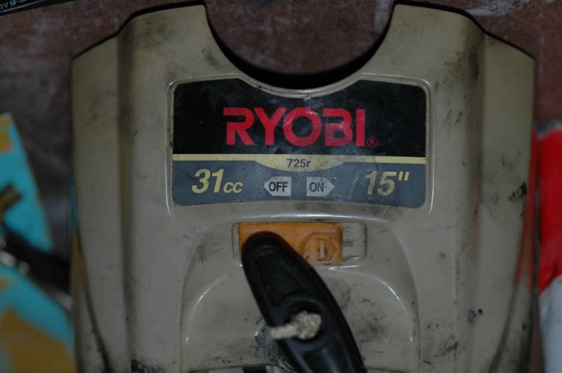

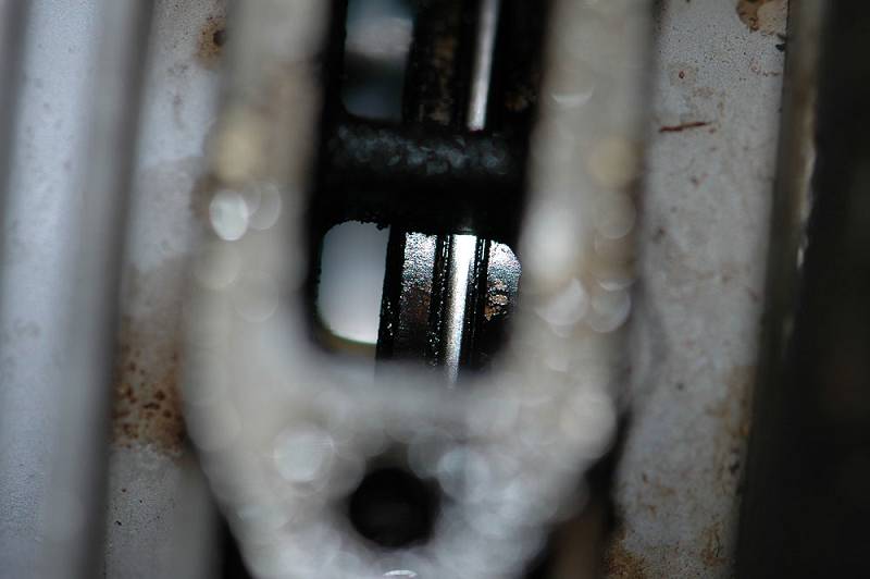

Here's some photos of a Ryobi I found. I think av8tor was saying this Ryobi isn't the most powerful of the 31 cc engines, maybe someone can say if it is or isn't (because of the bar in the exhaust?). The trimmer that it's on runs poorly and smokes a lot. Do you think the rings are bad? Here's some photos of the cylinder wall too.
The Homelite 25cc engines I have might be better for this size plane. One of those starts fine, acts like it needs a carb rebuild, and the other one smokes like a train. I'll try to get some photos of the one I choose this weekend.

I noticed my Homelites have a metal plate on the front of the engine. Can this be milled off? At least the exhaust on them are on the side and not the back like the Ryobi.
Old 07-02-2009 | 11:42 PM
w8ye's Avatar
My Feedback: (16)
Posts: 37,576
Received 11 Likes on 10 Posts
From: Shelby, OH
Default RE: Homelite 25cc conversion
Yes
I did a couple and I sawed them off on a big band saw and finished up with a big half round file rasp
