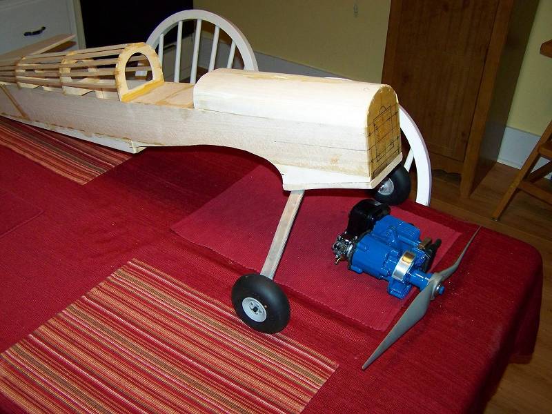

Seems this topic (Conversion Engines) needs a thread full of good conversion photos all in one handy thread. So how about posting your favorite photos of your conversion engine either mounted in your plane, setting on the bench, or heck.......you can just post a photo of your favorite weed whacker.lol
Here are a few photos of mine I wanted to share. The Rascal 110 has a Ryobi 31cc mounted in the nose. It is stock single ring with a stock Zama carb swinging an 18x6 prop around 7200rpm. Flys the plane scale-like and runs smooth as butter. The conversion parts were made by a fellow friend and flyer (RCU member XTOL).
The photo of the all blue engine is a 28.5cc Ryobi short shaft single ring with a Walbro carb. This engine is going into a giant profile plane, and then into a Super Sportster 90/120 size I am going to finish building this winter.
LETS SEE YOURS!!!!

I love your engine paint job. What did you use for paint ? As soon as I get
some good pictures, I will post mine. Good idea ! a picture is worth .

I use rust-oleum impliment paint. I just "deglaze" the engine using Dawn power desolver. It helps to create a surface that the paint really adheres to well and the paint also seems to hold up to the heat very good. As far as I can tell it has little or no negative effect on cooling. I have checked the head temps several time, and it runs cool as a cucumber and actually I have no proof, but I think it may also help to dampen the engines harmonics and give it a more mellow sound. The stock Ryobi finish is not exactly "purty". Ford Blue is kinda my color, and kinda makes my engines reflect my taste and personalizes it. I will look forward to your photos.

The paint does better if you bake it in the oven around 275-300 F after it has dried for a week.

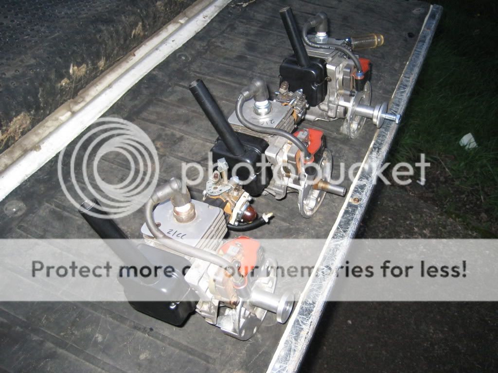

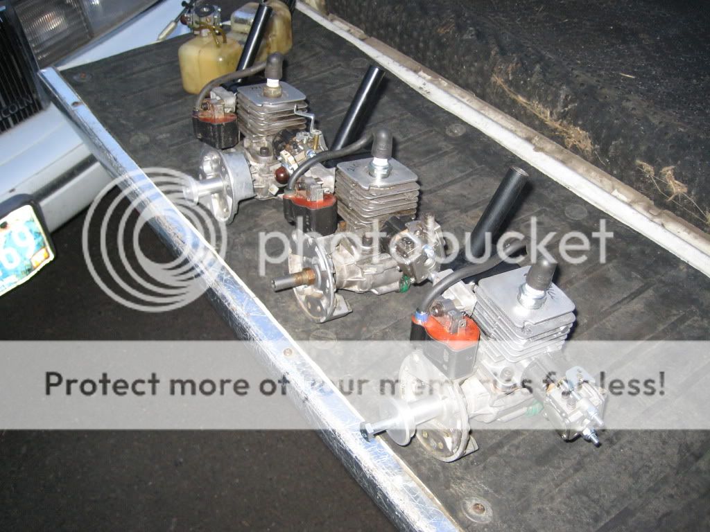

hmm, should have added in my conversions...
Poulan 21's:
Mac 32 on USL 120:
I have more on my computer, but it's still down from january when it crashed...
flew the USL on sunday, runs good just needed a bit of tuning and maybe a 18x6 prop instead of the 18x8

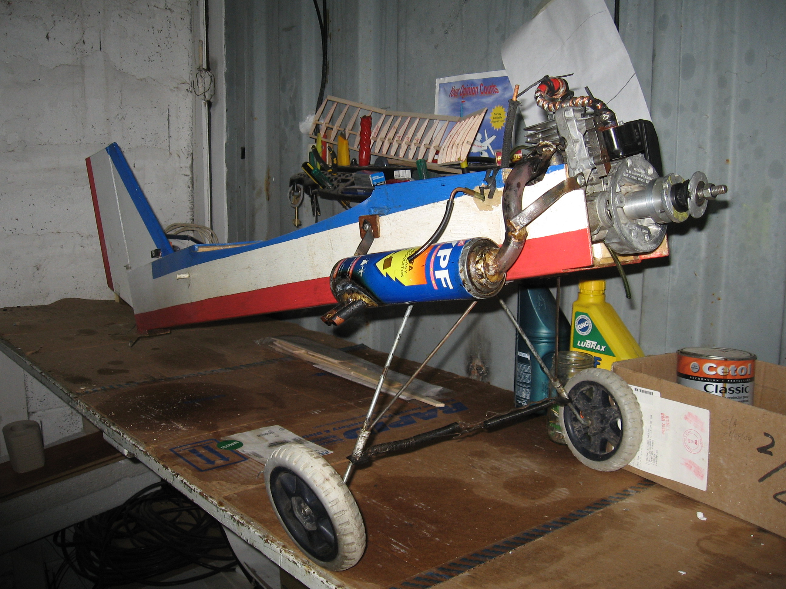

Hello
ohh my fingers, but you can see a Weedeater poulan 25 cc and the Pioneer chainsaw conversion 40cc, actually with broken engine block, but can survive if we solder it.
We have in our club a McCulloch 40 cc engine flying, good engine good compresion,and a Niwa/Toyama chinese chainsaw, soft compression but good engine.
Thanks to RCuniverse in part these engines perform well and in part to RCU members.

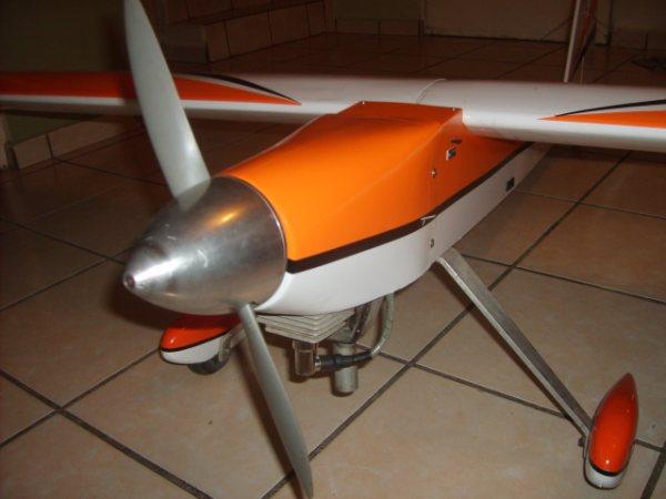

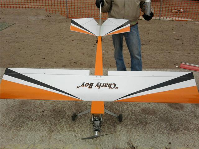

Here is one of mine a McCulloch 32CC and a Ryobi 31CC on two Charly Boys that I build and sell

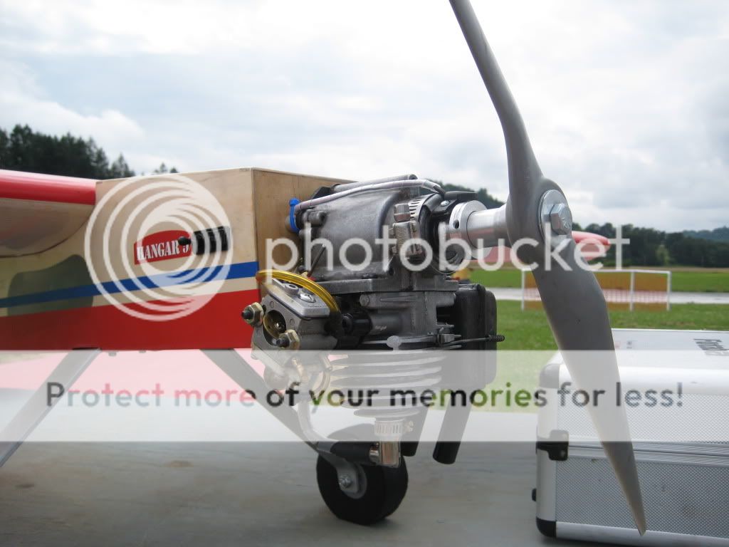

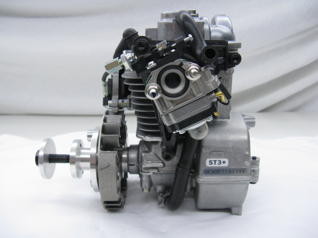

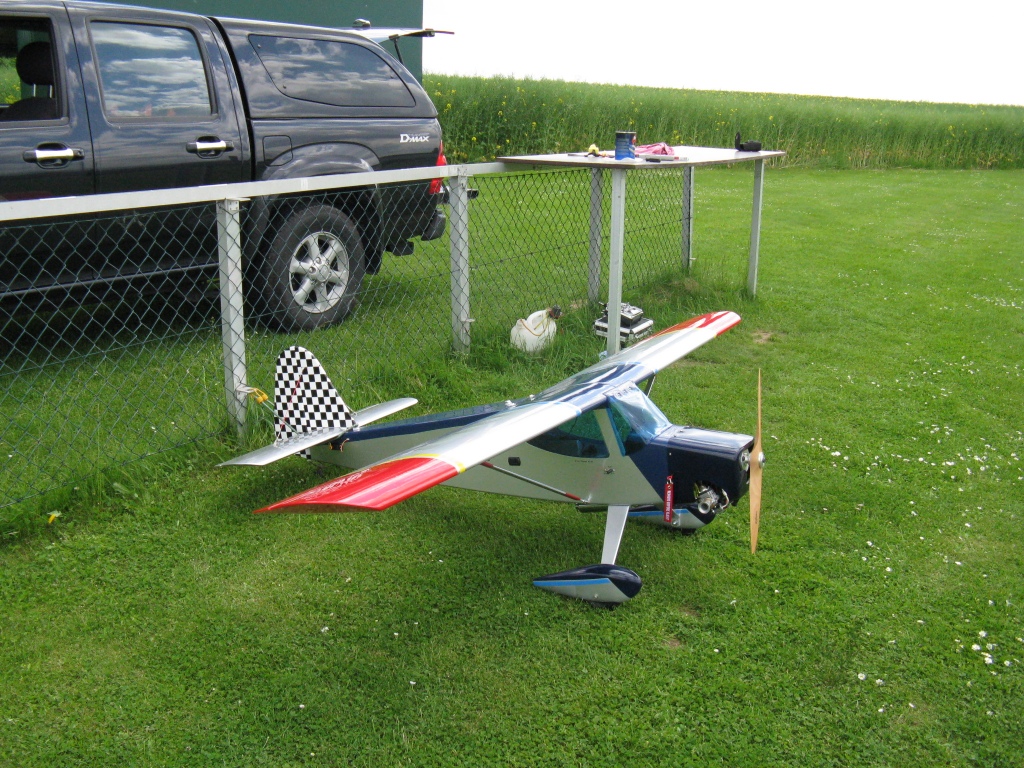

Here is my Honda GX35 working in a 2,4m Telemaster. Easy to start, runs great and the sound is beautiful.
For more information about this engine search here for GX35.
Some video and sound is here: http://media.rc-network.de/showgalle...500/ppuser/283

How do I get info on the Charly Boy. I have several converted engines that need an airplane.

Thomas,
Beautiful engine, plane and country side just East of Frankfurt

Twinstar, I build and sell these airplanes. give me a pm if you are interested.
